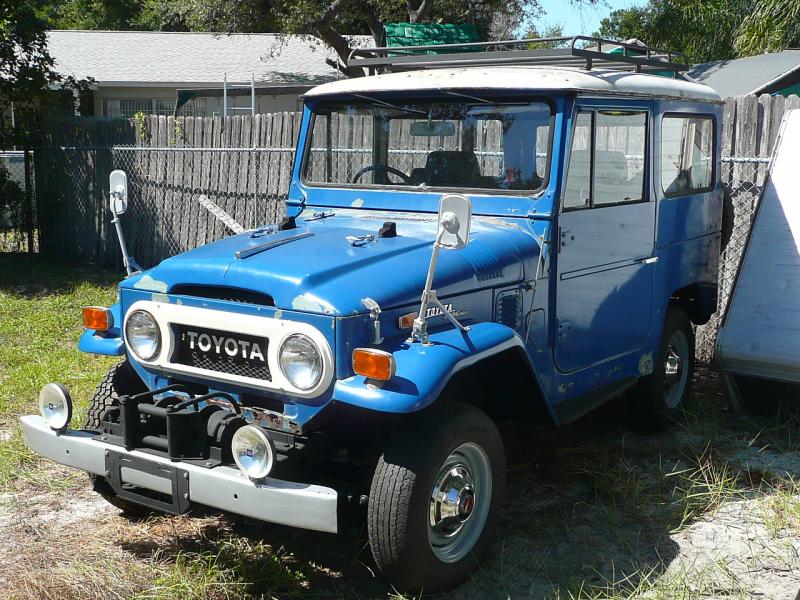

my rhd 1970 japan model have those mirrors,better view on the back and side, but i think there only good for city use.....even if you have to do some work on the engine bay they on the way -sometimes better remove it before tear it...and magnet for limbs on the trail
Well I have only used the fender mount mirrors as that what my truck came with. Shake is RPM dependent but yes- they shake. I have to bump up my idle to see out of the left one. The are great for seeing the rear wheels when backing up. Off road they get knocked out of alignment immediately- but I can't imagine that side mounted mirrors don't as well. They do catch limbs but they are sturdy and they are not going to get knocked off the truck or anything like that. The ones that you have are different that Eshu's. They do get in the way when working under the hood- but if you don't need to do that often then no big deal there. Stuff like replacing the pump diaphragm with the pump in place- then you basically have to take them off. Around town they are great- you do not even have to turn your head to see if there is someone next to you and in the winter if the side windows are fogged up you can still see.

Have those fender mounted mirrors installed for my Bj45. Unfortunately they shake at idle, but once my rig is moving it stops. Have to agree with peteinjp, when trailing, once the mirror gets knock out of alignment, you have to go down and adjust the mirrors. But at least they look cool.

There are 2 real advantages for them and that is that you can see the rear wheels when going around tight spots. You can tell if your clearing something or if your going to hit it. The other related advantage is that you do not have to turn you head from the direction of travel in order to do so. If only they could fold down when going into branches and when working under the hood. I think the ones that Eshu has could be make to do that somehow.
