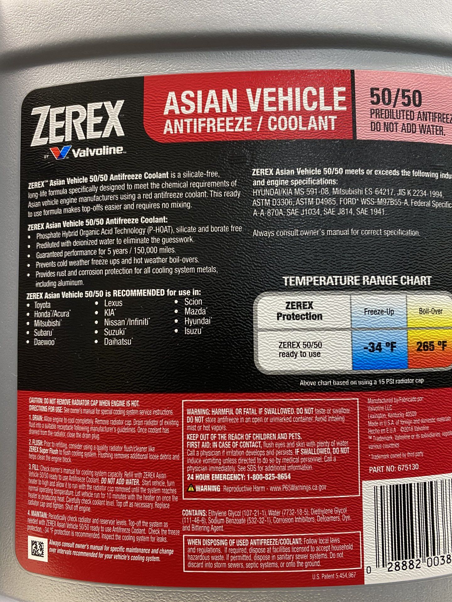

Ok, I have done my research in the forum. There is a lot of older information on Toyota red vs green antifreeze. I am putting a new aluminum radiator in my KZJ78 will be doing a full flush and want to out the right antifreeze in. I have been using OEM branded Toyota coolant which might be the pink version (hard to tell, they have since changed their packaging to state pink or red) I flush my coolant system every year. I have been reading very conflicting things. Is the standard IAT with silicate ok if flushed every year or should I be using HOAT non silicate long life and still flushing every year? Aluminum rad, but stock heater core. I don't have access to Toyota red from a dealer near me. Just Canadian Tire, napa etc.
