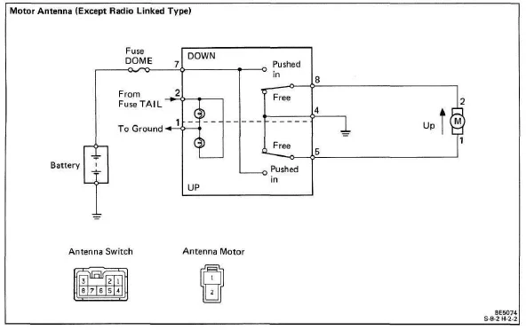

Where would be a good place to find the wiring diagram for the antenna? I would like to see how the Up/ Down antenna switches are wired up.
The FSM has all the electrical information you need.
I don't have a '91 manual, this is from the '90 (but it should be close):

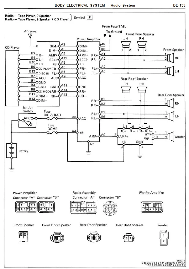

Since I don't know what options you have, here's the US standard 9 speaker w/ tape/CD:
