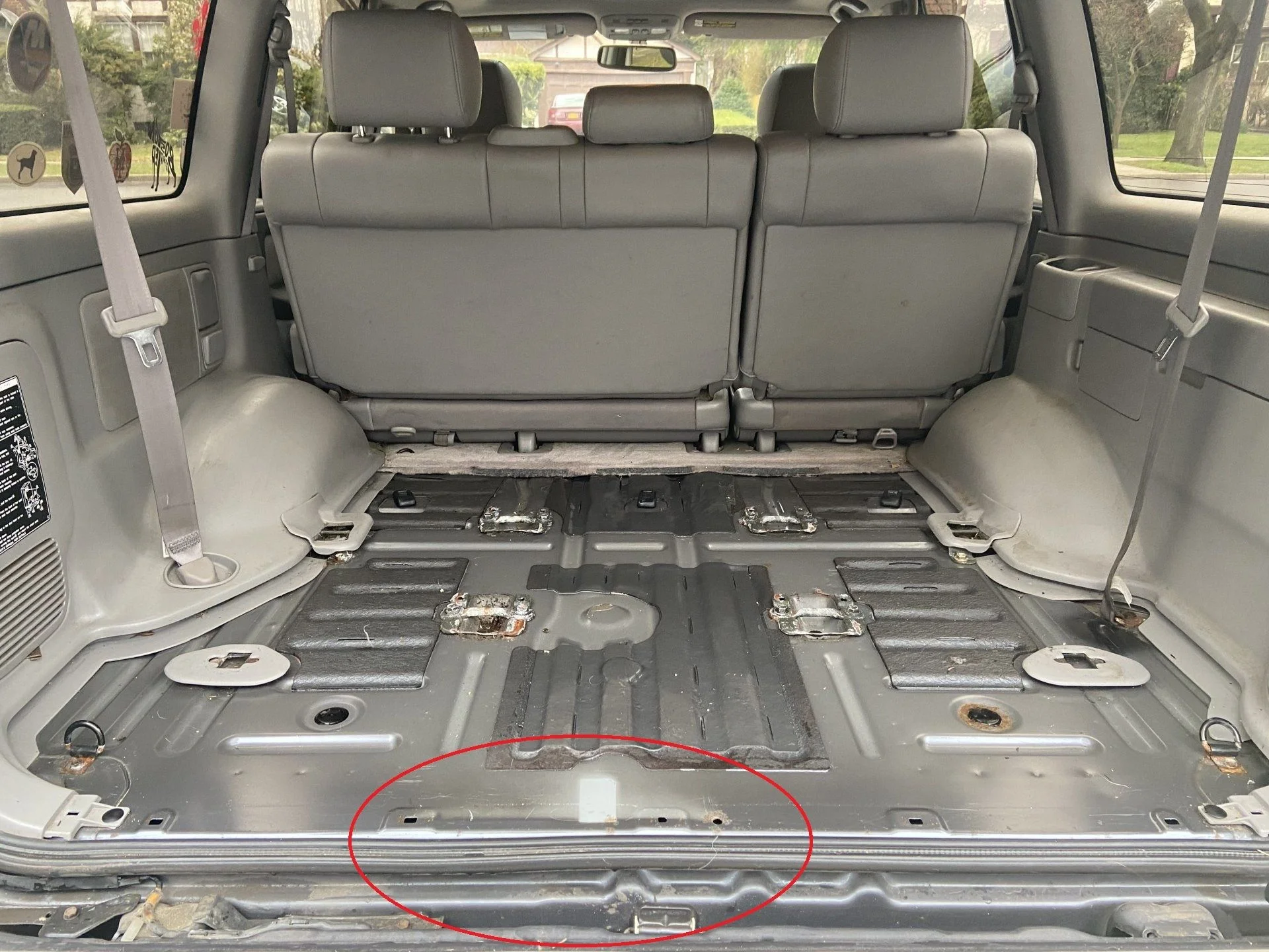

I see some damage to lower inside center body at gate seal area. Very likely a leak point. Leak in tail gate, hatch, 1/4 tips, tail lights or under-body rear are dangerous. Exhaust can and will enter these. Toyota OM recommends, never opening rear side windows with engine running, for this reason.
Look for any signs of rear impact, rust holes, drilling holes, etc.. Anywhere water can get in, so can gases.
Next start by looking from underside. Both 1/4 tips, making sure no open holes in bottom or side. Also check in fender well behind mud flap. Work you from one side to the other, looking for open hole in under body. Then check each tail lights seals. The corner tail lights once remove. Expose cavity of 1/4 panel tips. The lights housing have seal between them and body.

I see some damage to lower inside center body at gate seal area. Very likely a leak point. Leak in tail gate, hatch, 1/4 tips, tail lights or under-body rear are dangerous. Exhaust can and will enter these. Toyota OM recommends, never opening rear side windows with engine running, for this reason.View attachment 2644704
