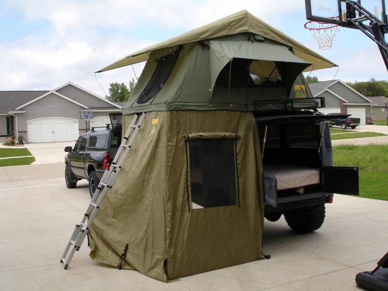

I have been building this for a couple of years, it's going to get paint the same color as my 68.
Thought I would post some pictures as I am getting ready for it's maiden voyage to the Tall Corn Cruiser Classic at the end of the month.
The RTT is for the kids and the queen inside is for me and the :princess:.

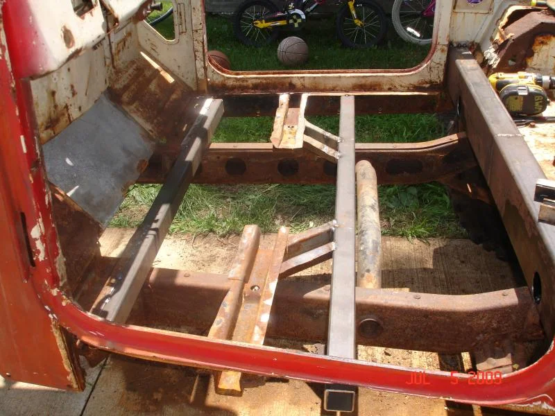

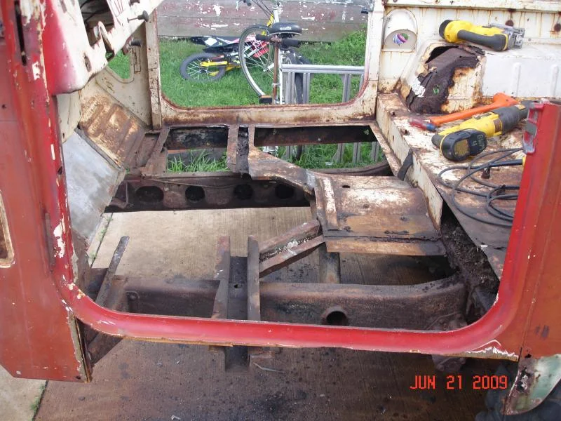

It was pretty rusted when I bought it.

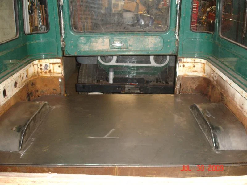

I cut every piece of floor out then put in new sheet metal.
This way worked with the blow up mattress, but not with a regular mattress like what I wanted to use. So I built it up to the wheel wells later in the build.

what purpose does the sheet metal forward of the firewall serve?

No water holding area, I filled that hole in. I am not planning on doing anything that extreme where I would need it.
Everything I did was to keep it dry inside, a solid sheet across the firewall helped out a bunch, plus, it was there when I bought it.

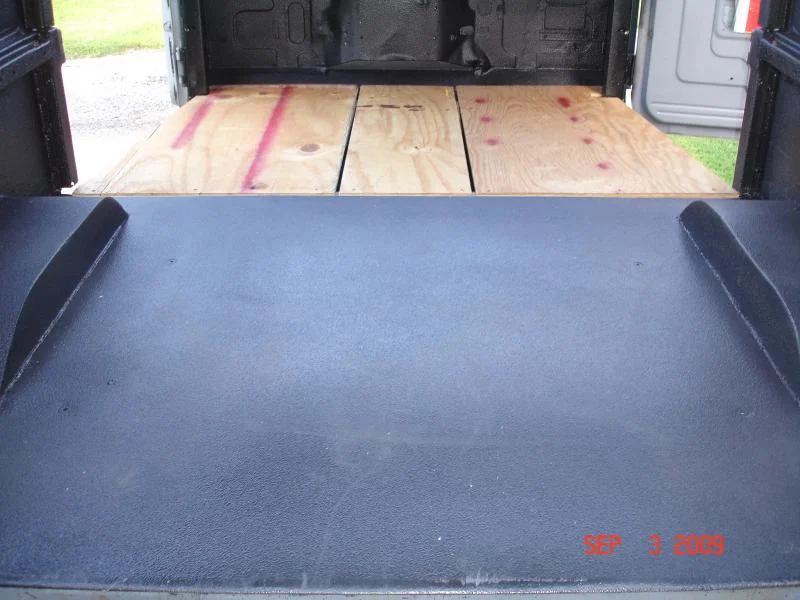

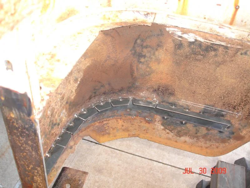

You can see how low my finder well are now, I laid them right on the flange of the old wheel well.

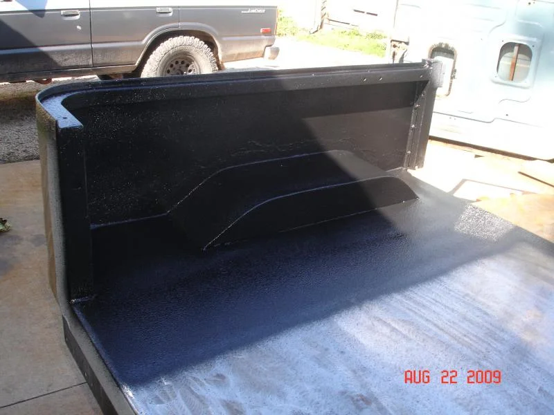

Sandblasted then U-pol Raptor the whole inside, again for a water sealant. This stuff works great, smooth to the touch.
