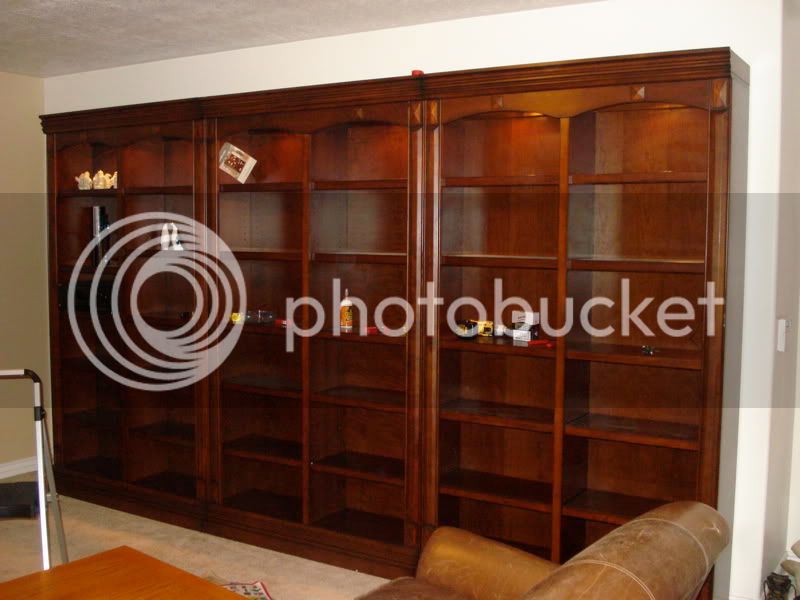

I recently bought 3 large bookcases from Costco. Each bookcase has 2 small 'puck style' halogen lights in the top. The lights are switched on (3 phase brightness) by touching a small silver dollar sized metal disk.

Ta-daa! Instant Library.
