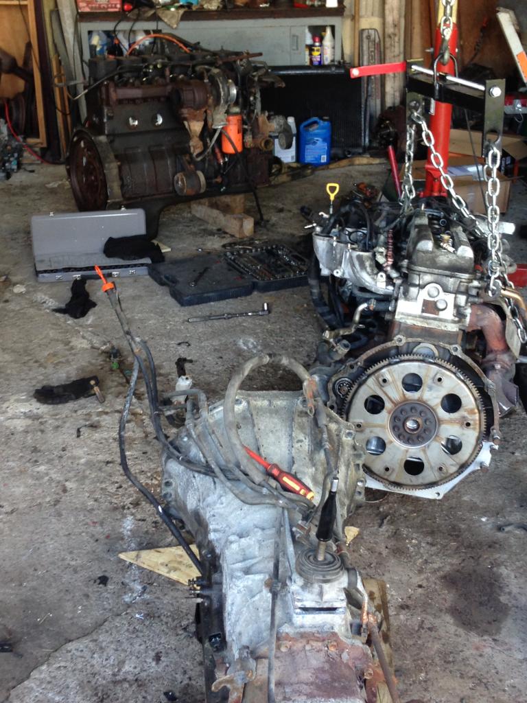

What kind of engine lift are you using? Need to buy one eventually.

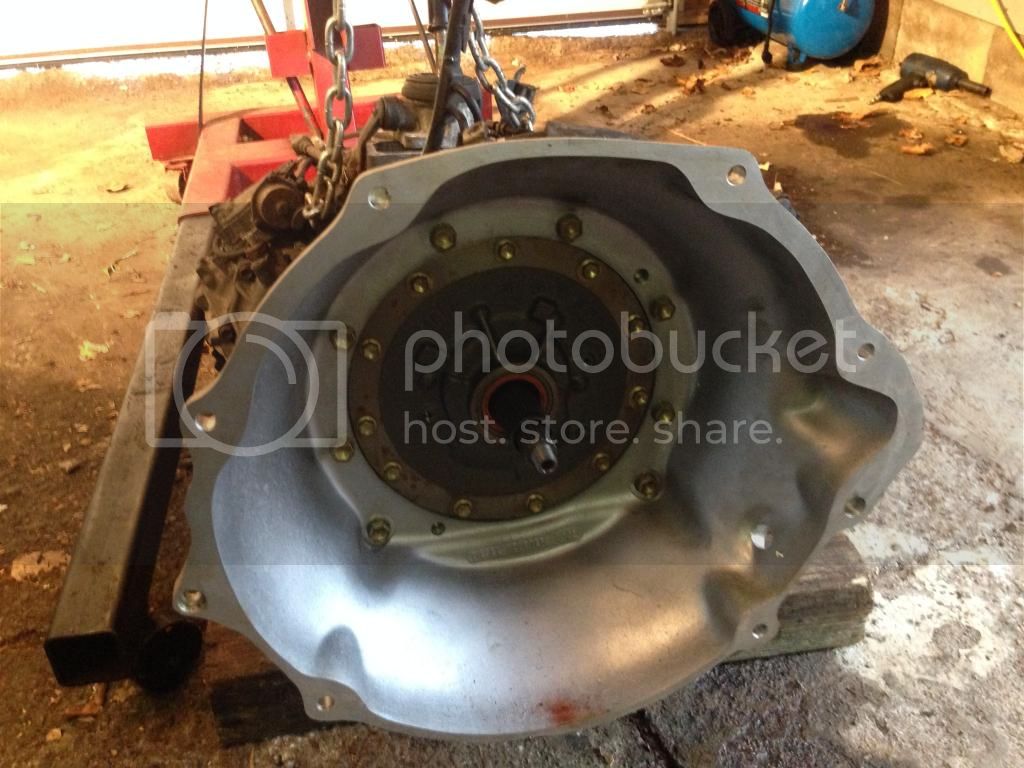

Are you running a ve or p-pump motor? Also looks like your using the 442 bus tranny? I'm yet to see someone use that trans. I plan on bolting the bus tranny behind my p-pump motor. Looks great so far!

Ya p-pump and bus tranny.
What do you think of those bolts for the torque converter to the flywheel too weak? Grade 8 for peace of mind?
Get some arp or grade 8. Make sure you get the correct length as well. Are you doing any mods i.e fuel plate,timing, injectors?
I think bumping the timing and adding a fuel
Plate would be safe. I'm going to run a bigger turbo then what Dustin "plans" for. I want to see what the limits are of this Aisin trans. Honestly I think it's a beefier trans than the 47re. The questionable spot is the torque converter
