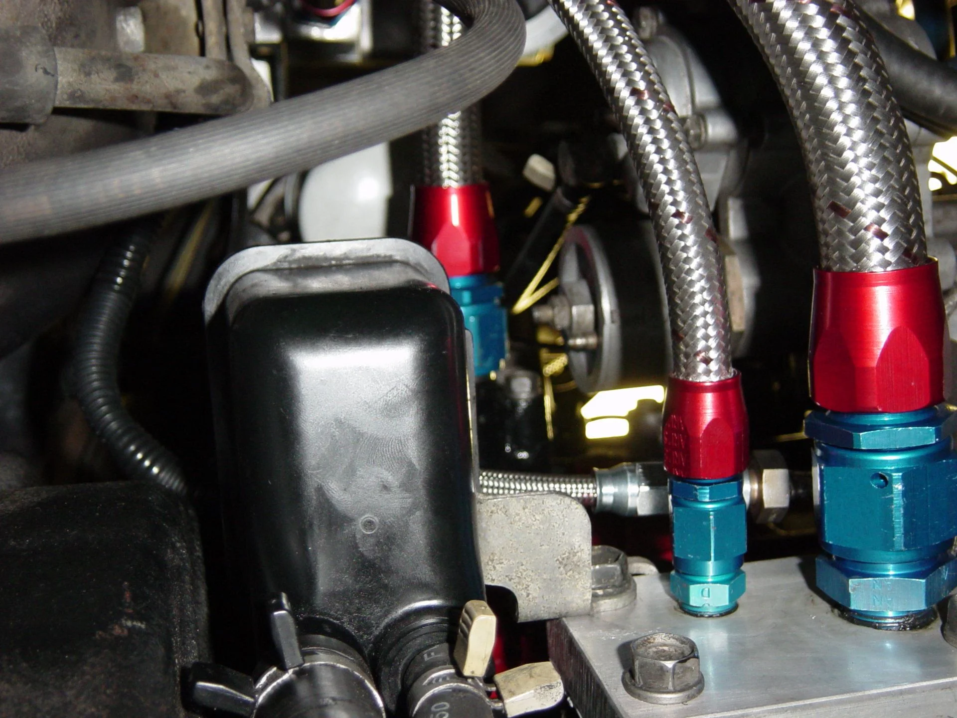

Here is a picture of my set up - Best picture I have. Valve cover hose goes to the top, small hose on bottom right drains oil into sump, larger hose on left vents to atmosphere.
