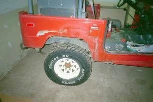

1981 BJ42, tub in sad shape. I drove it for a number of years before the project began. I do not weld, so this was a huge consideration when deciding about steel or aluminium. I also was considering a Gozzard tub, however when I was ready to go, Mike had just decided he was going to sell to authorized installers only.

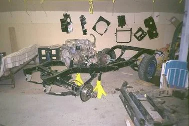

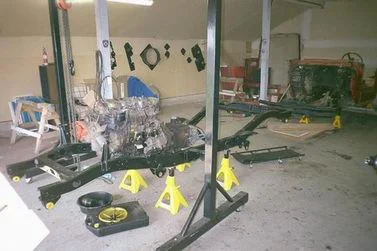

I got a second frame and worked it the summer before the truck went off the road. I sandblasted it, and then it was dipped, and pickled at Redi-Strip in Richmond BC. Canadian Auto Restorations then mounted the frame on a rotisserie, two part epoxy primed inside and out, and edura painted it. (I was undecided about galvanizing, as I thought I might do a shackle reversal and Saginaw p/s at some point. Knowing what I know now, I would have had it galvanized and painted it myself, however what I did will be good for years.
I then parked the truck, started dismantling, moved the drive train over to the new frame, putting in a new clutch, pilot bearing, rear main seal, engine mounts. etc with the help of a good friend. The transfer case had been rebuilt prior, as had the front axle, so they were all moved over after cleaning and painting. New custom springs were installed, front and rear brakes were done, and I had a rolling chassis.

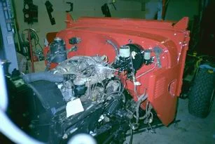

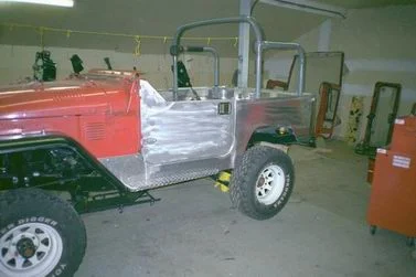

I moved the body over to the rolling chassis, mounted the doors, and front clip, lined everything up (I was not going to replace/repair the hard top---had been out wheeling the night the insurance ran out and put the truck on it's side, damaging the hard top), and bolted it all in place. The old tub was cut off, using the video tape and instructions Aqualu supplied. I mounted the new tub, adjusted things, and discovered I did not like the single bolt on the A post idea that Aqualu uses (it likely is just fine...I'm just anal about some things). I had some minor rust at the bottom of the A post on the drivers side, so I farmed out repairing this rust, and also extending the A post to the bottom of the rocker, with some angle iron. I could then have two points on each A post (one above and one below the floor pan). The truck was re-assembled once more, and I started lining things up for final drilling. I took everything apart, then put it all back together, got the same marks lined up, so was comfortable drilling holes for the final mating of the tub to the firewall/front clip. Everything was then taken apart, and all steel was sent out for acid dipping, zinc phosphating, two part epoxy priming, and freeborn 309 RM urethane (I did not go base clear). All aluminium parts were acid etched, primed, body worked, and then primed/painted.
Numerous trips to the painter ensued while I picked up everything, then started the final assembly. All places where aluminium and steel touch have at least 4 layers of primer/paint between them, as well as Silkaflex at the main seam, and rubber gaskets everywhere else. Stainless hardwear with anti-seize compound is used throughout.

Attached are a few pictures of the way it was.
gb

The worked frame getting ready for the old tub

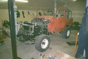

Old tub on the rolling chassis, and then first fit with the aluminum tub

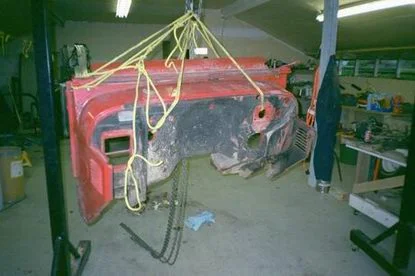

Final fit detail at the main seam, and firewall removed and heading out for cleaning, pickling, and zinc phosphating

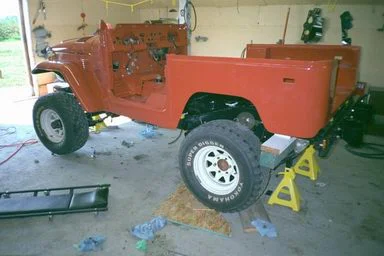

Bits and pieces coming back from the painters, or from my have blasted and POR'd and top coated.

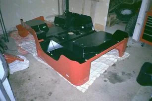

Tub painted and ready, firewall back on the frame (I decided it was easier on the knees and back to put the harness back in while I could stand in front of the dash), and finally the tub and firewall ready for the application of the Silkaflex, and bolting together.

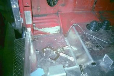

Detail of the A post extension, so I could bolt the firewall to the tub above and below the floor pan

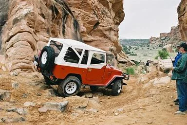

Finished, and at Elephant Hill in Moab!
