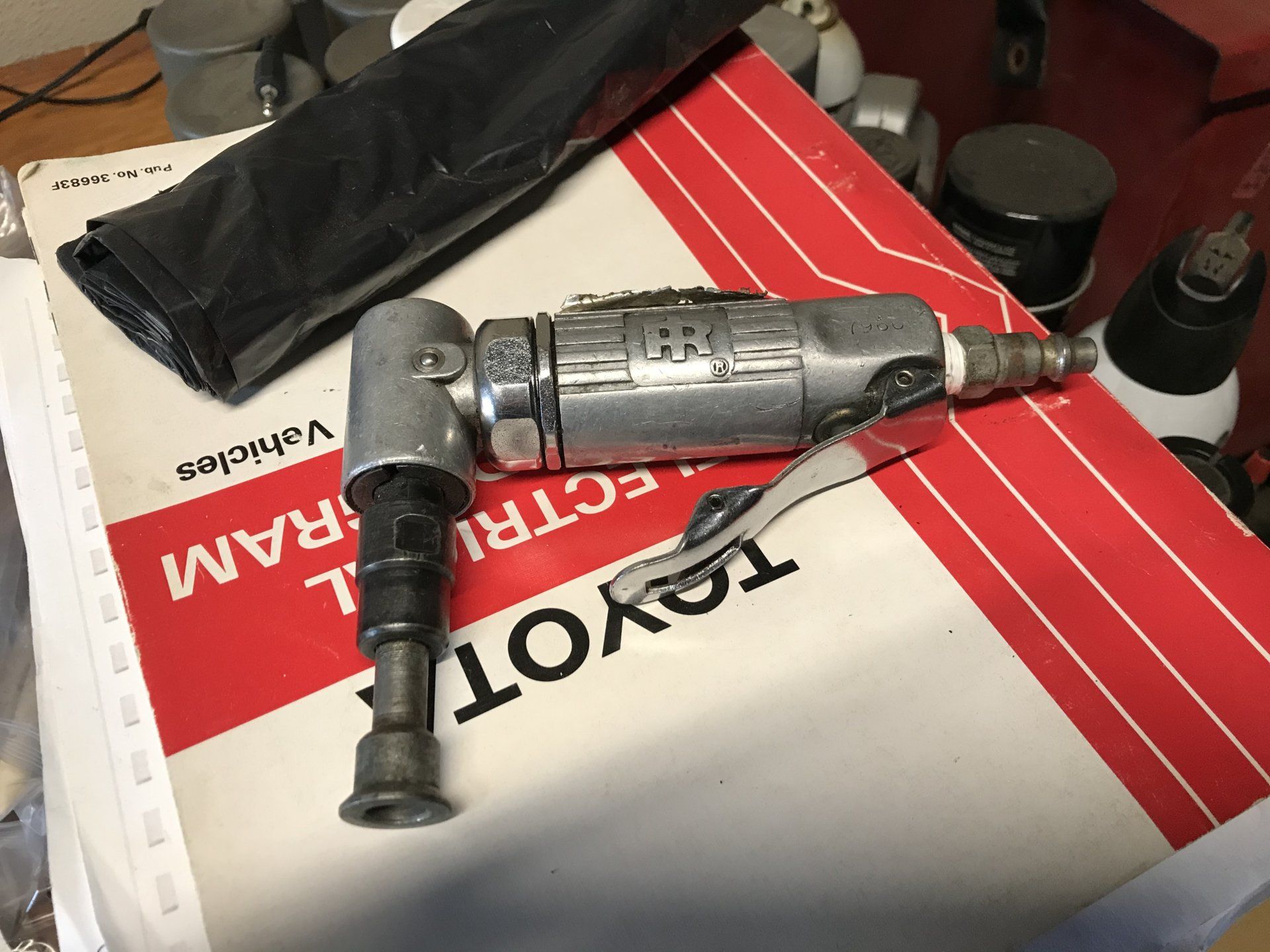

I bought an air compressor and then I bought some air tools (all second hand). Now I have an angle grinder and I’d like to get to grinding. But I can’t figure out how to change the tool/attachment on the business end.

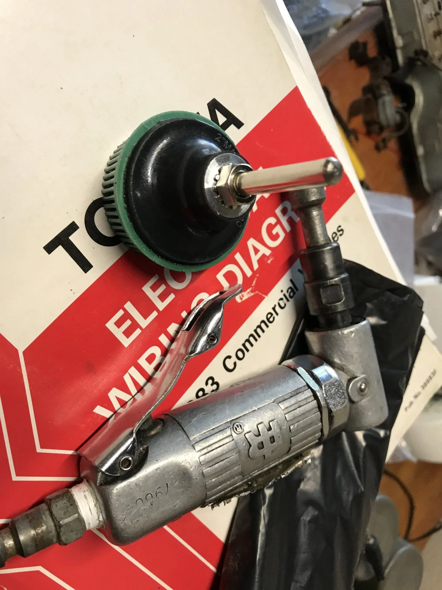

This Roloc wheel is what I want to attach to the grinder.

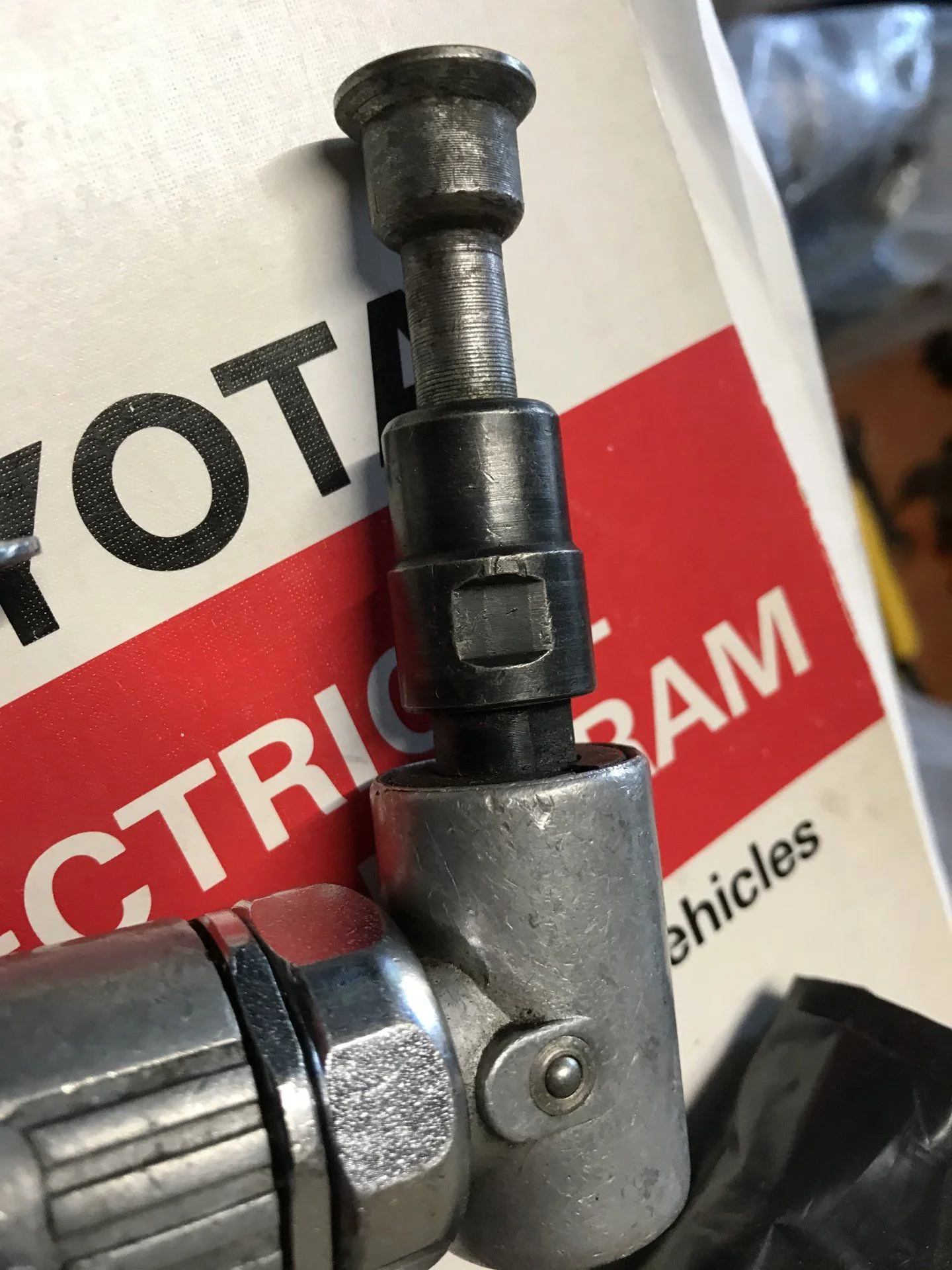

I’m assuming the flat spots on the head are key, but there is nothing that holds it in place to keep it from spinning if I were to try to wrench it loose.
What do I do here?!?
You typically need the sheet metal wrench for the inner one - since it's so narrow. But both are typically standard sizes. So you can use a regular wrench for the outer one and grind one thinner for the inner one - I typically pick up some cheapo wrenches from Horrible Fright for such modifications.
