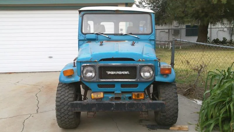

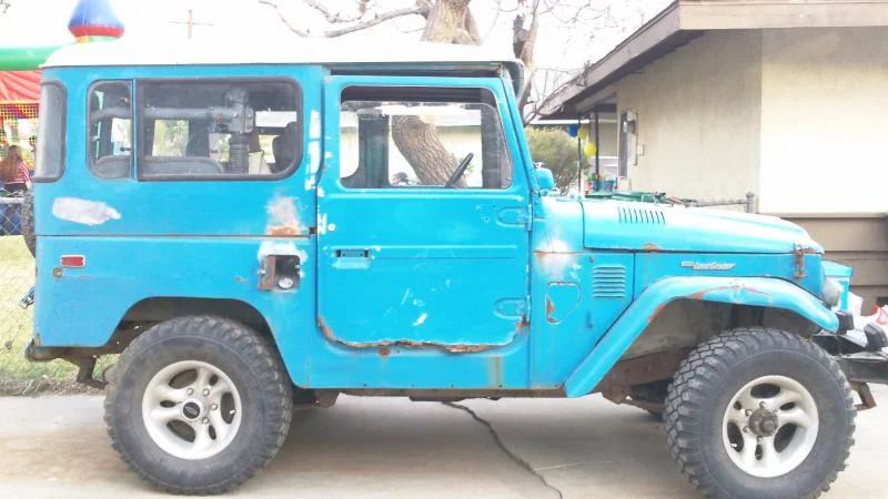

Here she is as we found her... warning: shes rough.
Passenger side tub has rear quarter damage. Top doesnt line up right. Not sure if she was rolled, But the frame was straight and it tracked straight.

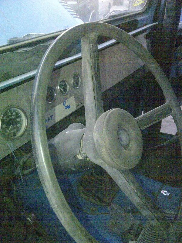

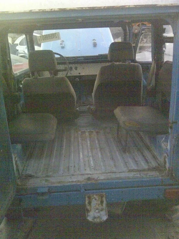

Some Interior to show how ugly she was.
The PO had screwed in an alum dash and cut into the original to make room for aftermarket guages:mad:. i was originally worried when i first saw this as i thought id have to fuse in a new dash but when i removed the diamond plate, I actually found that the original dash wasnt in toooo bad of shape.

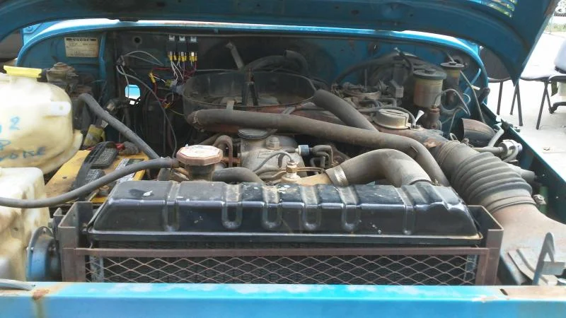

Engine compartment pics

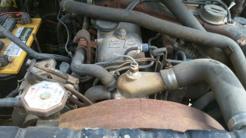

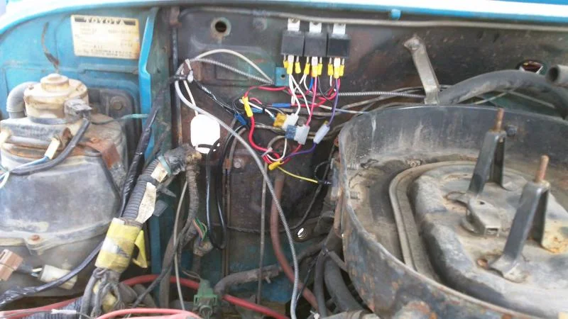

So here is the engine compartment. Lots of rust and tons of grease.:frown: The good thing is that most everything is there. The bad thing is that apparently there was an electrical fire under the dash (cowl) area that seems to have probably started where the engine wiring harness entered the firewall. Im GUESSING the grommet wore/tore through and the wires rubbed themselves to copper on the firewall opening and arced there. i dont know. Just a guess. So I was missing quite a bit on this 40 but im sure Ebay and the classifieds here will be a huge help.
Pic 1- tight shot of the engine
Pic 2- Larger overall pic. I have the air cleaner lid. you can also see the non factory wiring.
Pic 3- is a shot of where the harness melted as it entered the firewall. The harness is intact from the firewall to engine but anything that went in to cabin is gone. So we will have to figure out a way to maybe salvage it.

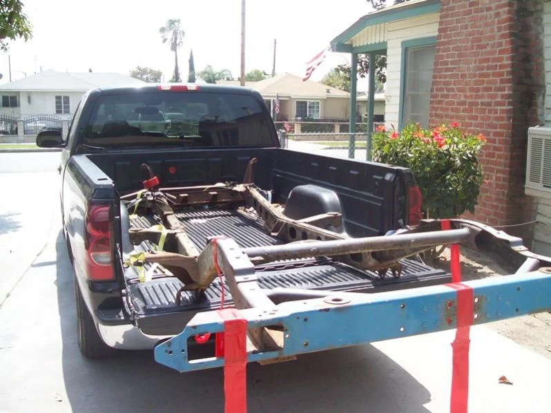

Tub Dolly

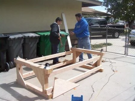

Me and my boy decided after reading different build threads that we would need a dolly to move the tub around easily. So we slapped one together out of some left over 4x4s from on of my jobsites and some casters from the Home Depot. It took us about 30 minutes and works as expected. The back casters are fixed and the front swivel and that makes it very easy to manuever.
Pic 1- Building the dolly.
Pic 2 & 3- The frame without the tub.

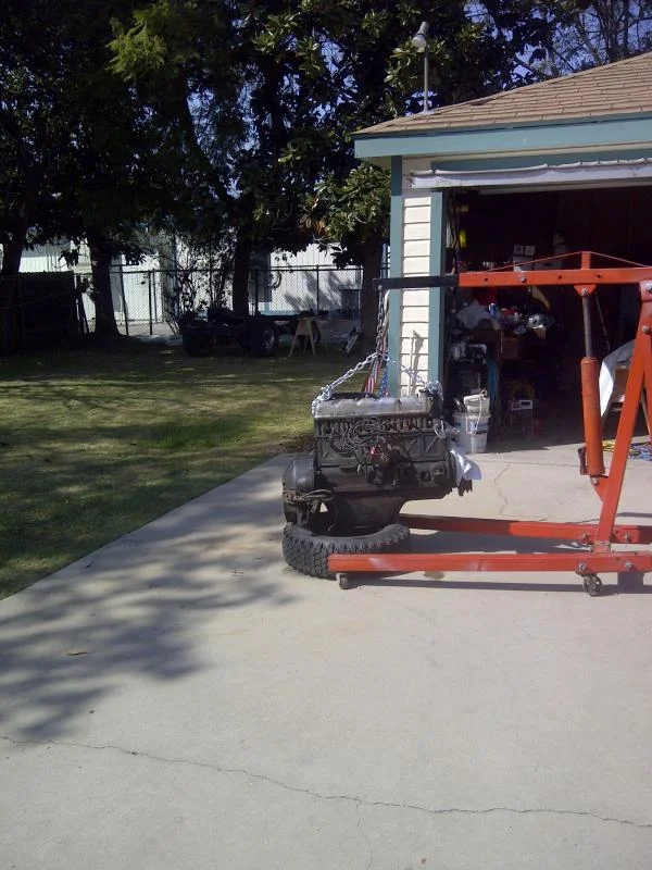

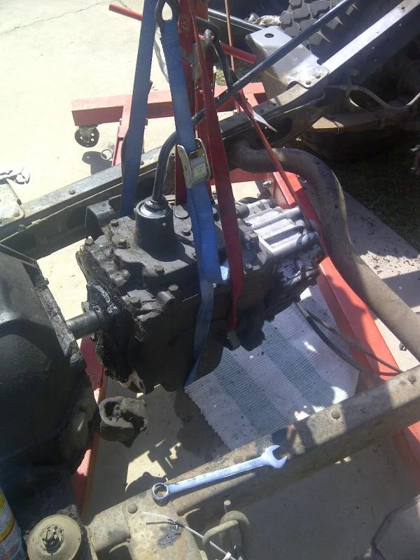

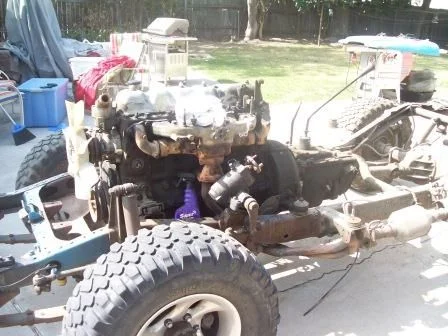

Tranny and Motor are out....
Tranny and motor are pulled. Going to send the Trans and transfercase to a friend whos rebuilt his and who I trust. Engine is gonna be degreased and all new seals and gaskets plus a fresh coat of paint. The grease and dirt on the transfercase is baked on ... seems to be clay but with swome elbow grease .. it should be looking good soon.

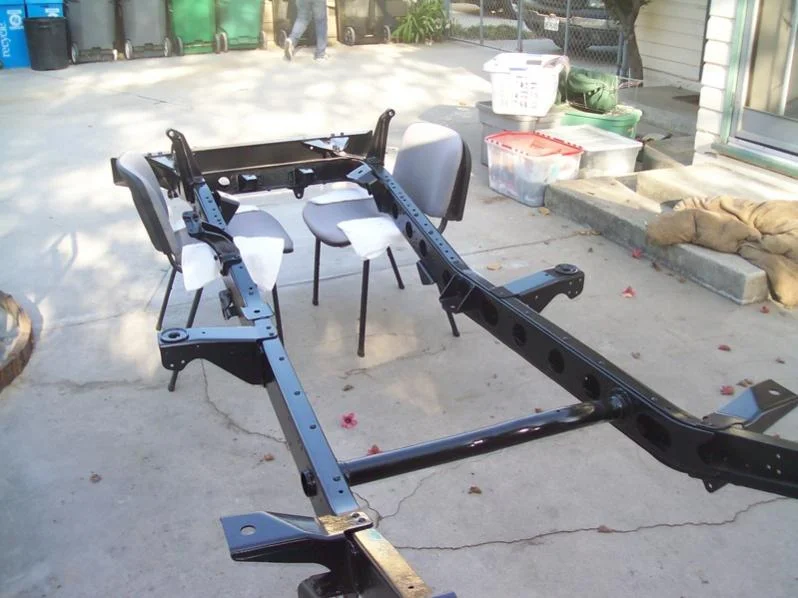

Frame to Powder Coat
So the frame was stripped and sent off to the sandblast and Powder coat company close by at Legions Powder Coating in South El Monte, Ca. The guys really took care of me. Not only was the turnaround quick but they allowed me to inspect the frame after sandblasting, to make sure it was done thoroughly. And of course it was. So they went ahead and powdercoated it a semi gloss black. All said and done the total for sandblasting and powdercoating was $300. They were able to knock it out in a little less than a week and a half.
