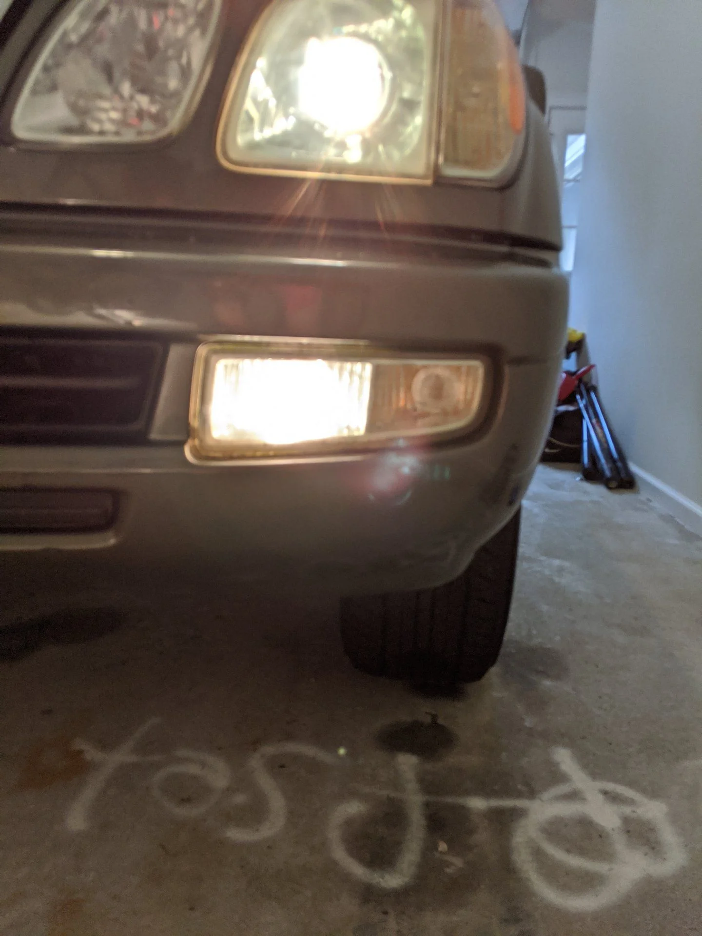

Hey guys,
I've just bought my 1st 100 series, LX470. Wanting to remove the OEM fog light bulb and put in an amber/yellow upgraded bulb. I've searched and searched and just not seeing something that definitely feels like it is what I want. Lame question, I know...but super grateful for anyone who has done this and can share which bulb you bought. This was uper easy to find for my FJ 🤷‍♂️

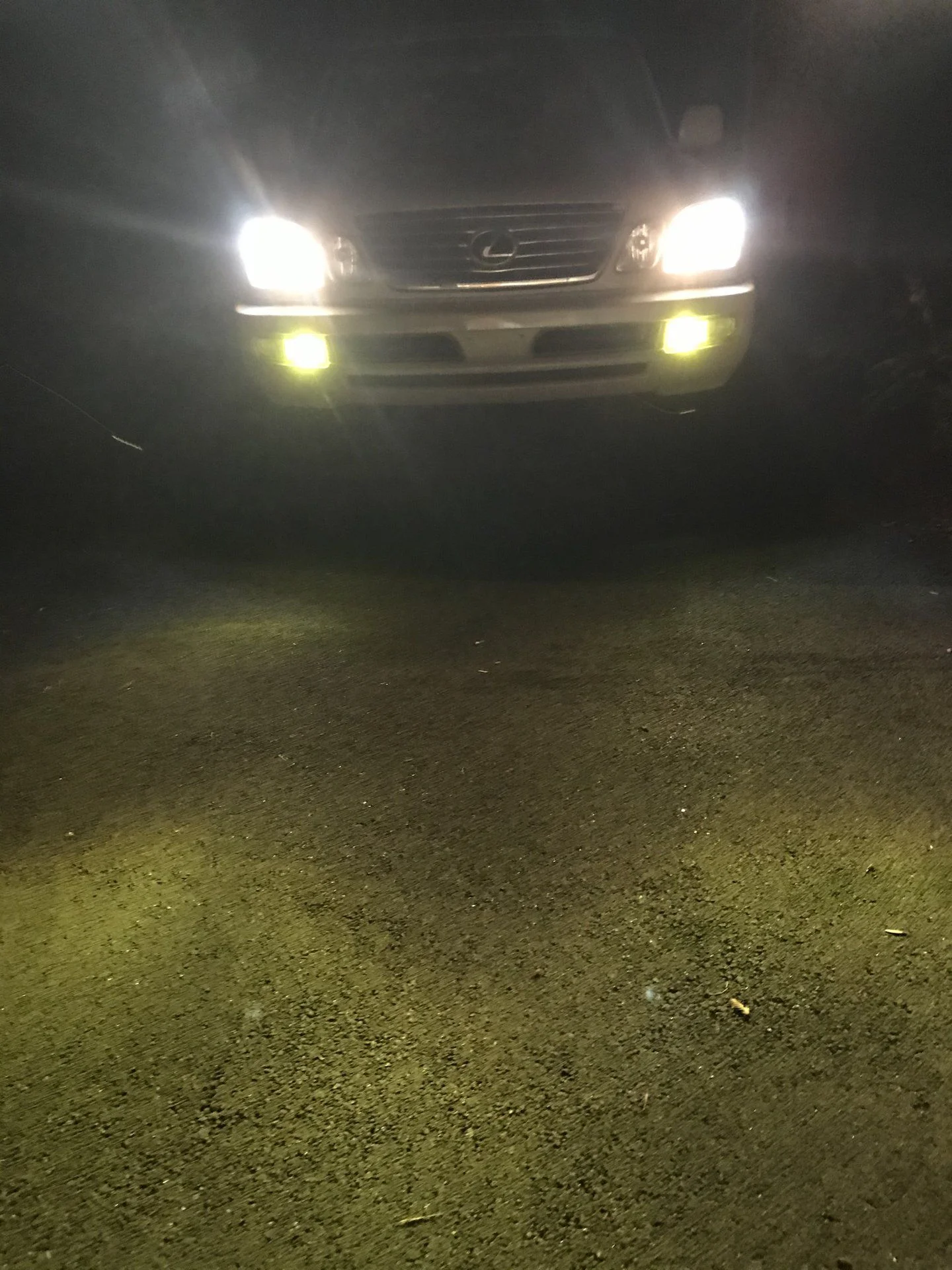

These color match perfectly for yellow fogs and parking lights:
Parking lights
Fog lights
EDIT: these are 3000K, which is the popular yellow color.

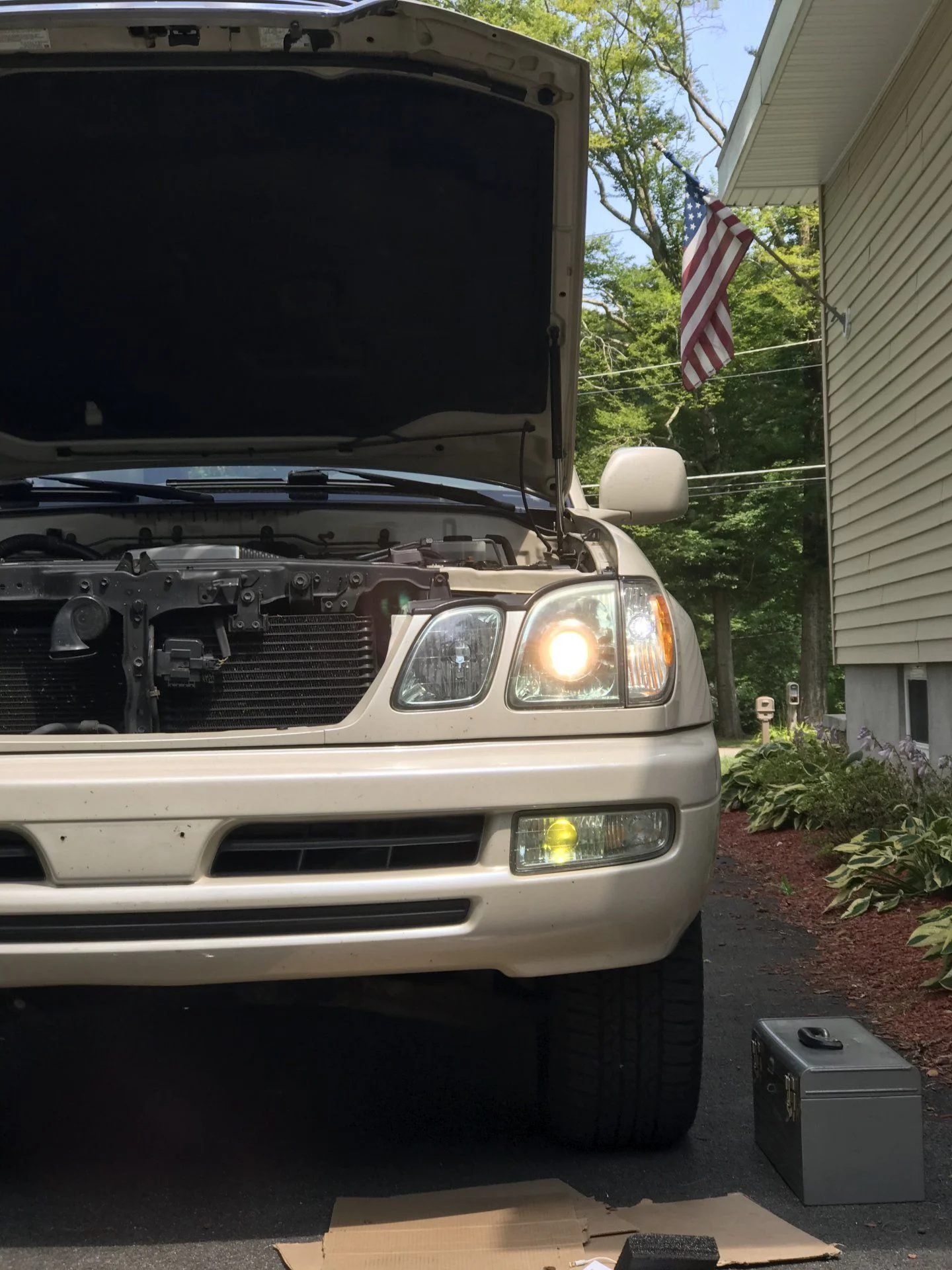

these are the amazon h3 LED switchback 6k - 3k in the oem fog housings. Plug and play no cutting or issues with the install. Didnt even have to remove the housing. Better than oem light output but not a HID level of lumens.
I'm running DEPO fogs with Sylvania 3000k fogs and they are super yellow. They contrast nicely to the HID headlights at 4300k.
