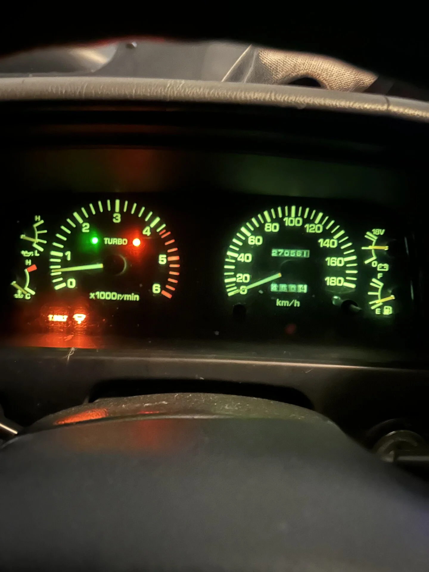

I am honestly not sure what the lights are but here is a picture of my dash showing the lights
You can see that the voltage is not yet where it should be…it eventually (~10 seconds) get midway between the center mark and 18v.
Again, I am reading 14.2v at each battery once the lights go out.
Is it the original alternator?
If so you may want to check and replace (very easy) the bushes on the alternator as they may be worn down or sticking.
taking a few seconds for the voltage gauge to move up to 'normal' - is there any visible oil leak dripping onto the alternator as it could be the cause. - similar thing happens when washing an engine and water gets in the alternator in that until its dispersed the alternator will show no charge.
I can only assume it is the original alternator. It is a Denso so I guess I’ll have it repaired.
No oil leaks or water on it. All connections seem fine.
