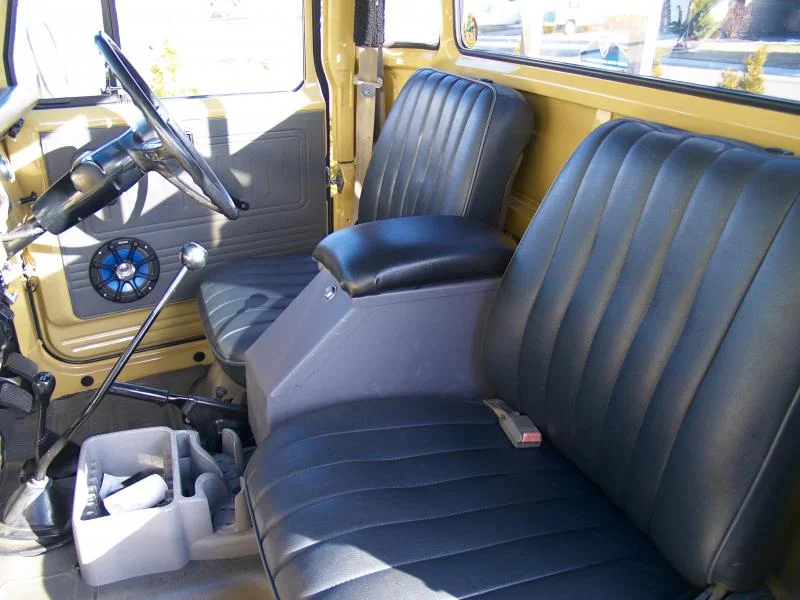

Looks great.
What seats did you use?

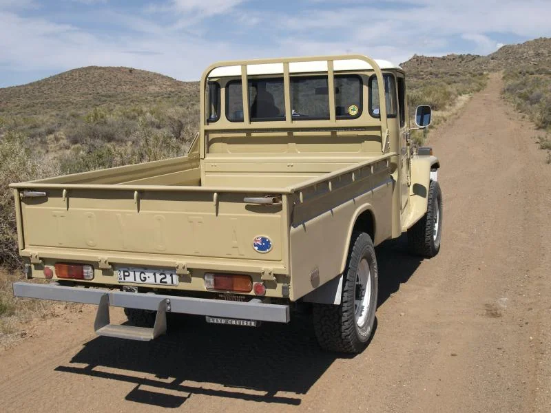

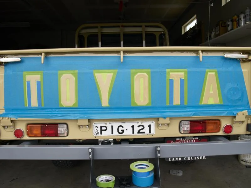

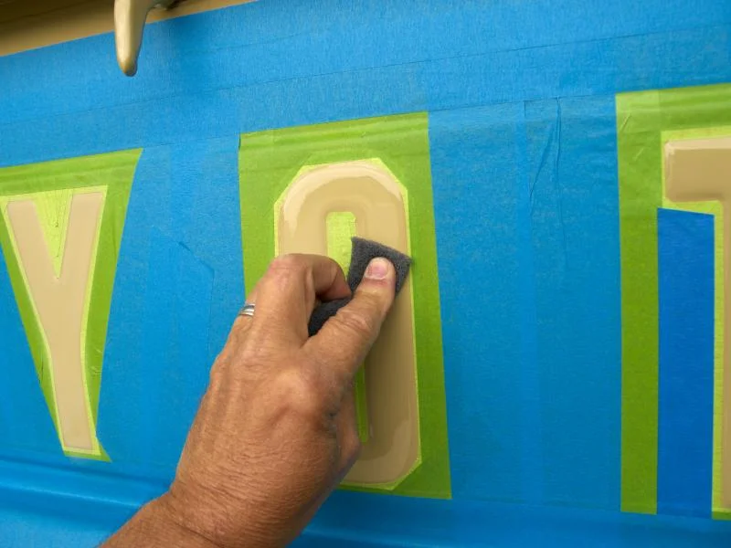

The painting of the tailgate letters was the very last item to be complete from the body/paint build. DONE, much better.

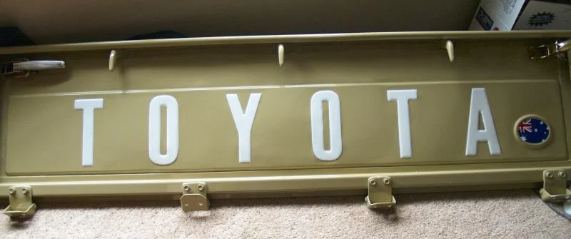

Thanks guys it does pop out now with the letters high lighted. The letter tape I got at the auto body shop was the key, without that and a good scrub pad it may of turned out different. I guess I can say I am really done now but I will leave it at 99.9%, as we all know we really are never truly done.

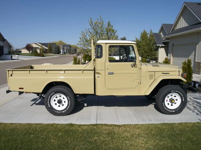

Wow that's one nice 45! Personally, I don't like the wheels (rims), but of course that's personal opinion. I have envy, the good one tho. Congrats and enjoy!
The tape I am referring to is the tape used to go around the outside of the tailgate letter (TOYOTA). Good quality 1/8 trim tape at any auto paint supply. The letters were painted when all the tailgate area was masked off. Use a spray can of gloss white made by SEM. Took about 1 hour to mask all the letters.

SOOT, I know I am at the end of my build and you should be somewhere in the middle of yours so I will be watching for you and your work, should turn out to be one of the best in Australia. As for the flag, my whole family but me :meh: are all from Great Britain and my uncle and aunt and cousins are from Perth so have a little fondness for both, it's in the blood.
