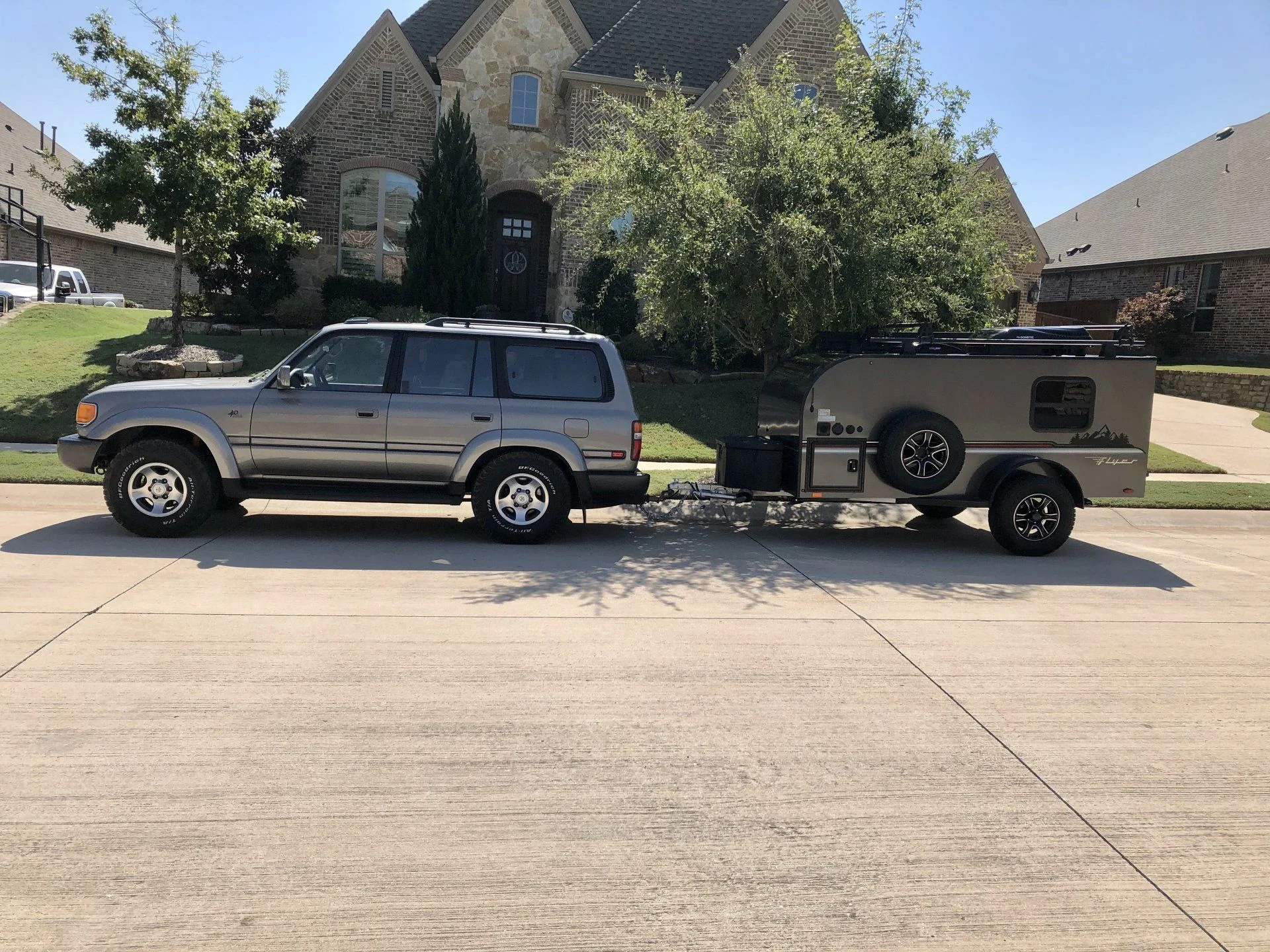

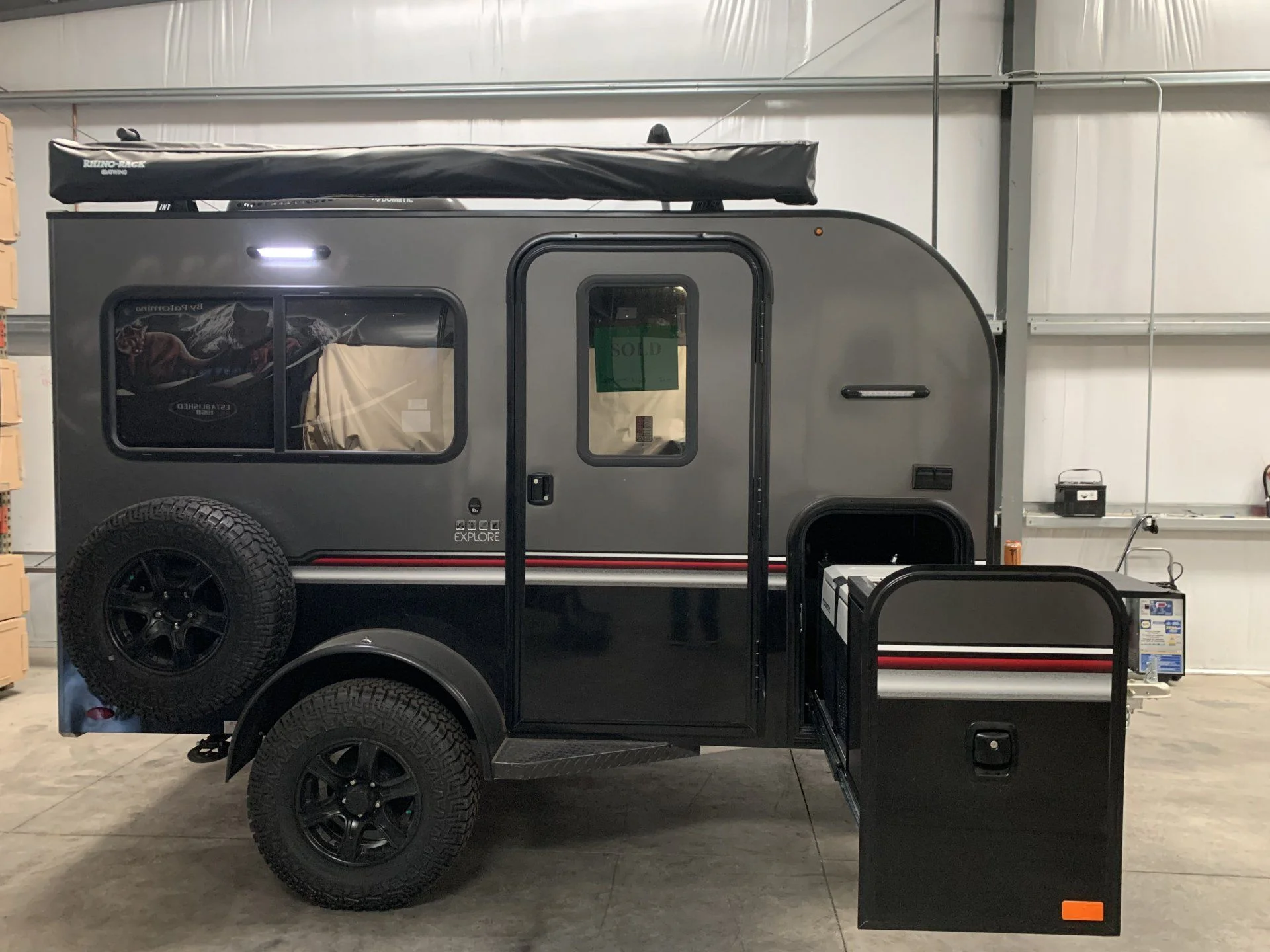

How do you like your intech explore? i've been looking at them very very closely in the last few months.. I love the fact that there is so much space inside but it is slightly taller than most of the other "overland" trailers. Have you taken it down any trails/rocks? Others that I have been cross shopping were the overkill campers SO 5-10 and offgrid trailers pando 2.0Air bags man! That trailer shouldn’t have more then a 500lb tongue weight.
I almost bought that trailer about 5 months ago but I was detected when I seen the aluminum frame. Good for weight savings but I thought it’s too brittle to take it off road...let alone have to repair it.

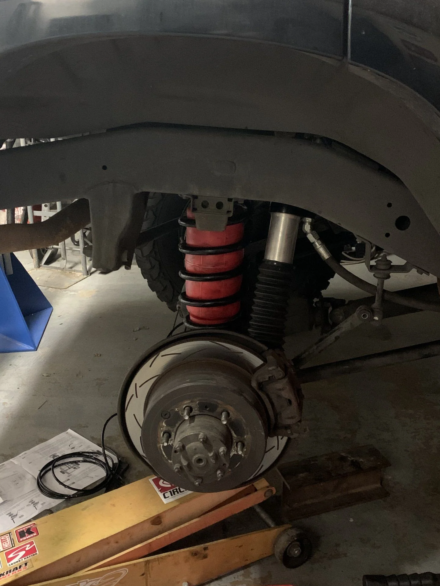

I'm curious why you still chose Timbren over airbags first, since no one here have them a thumbs up and they pointed out the exact problem you would have?Update: Tried the Timbren helpers and it rode like a log truck so I went airbags and that’s the ticket. The Timbrens contacted the axle and were compressed even when unloaded so it was probably a fitment issue rather than the product itself. E-trailer refunded no issue so +1 for their customer service
Fair question... I bought both. The timbrens are as easy as removing/installing the frame bump stops so I figured I’d give them a try for science, and because you don’t have to mess with inflate/deflate/leaks. I’ve already had one bag give up, for example. Getting the bags in and out of there is a real pain in the butthole. They work well though.I'm not trying to be a dick, I'm looking for the logic.
