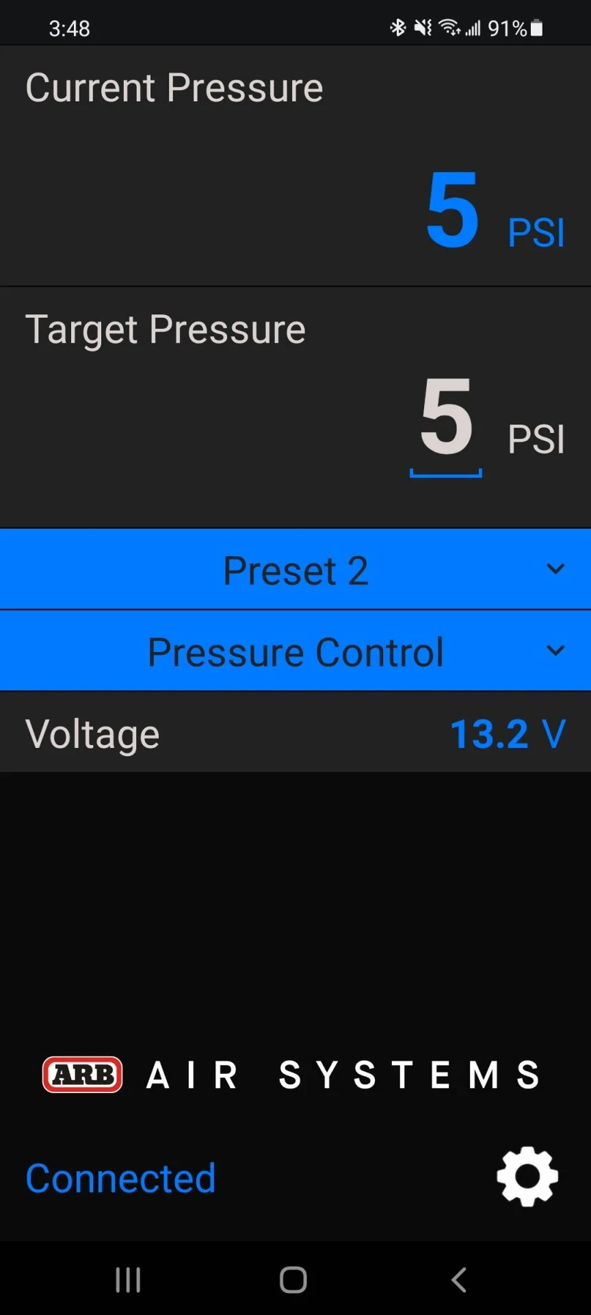

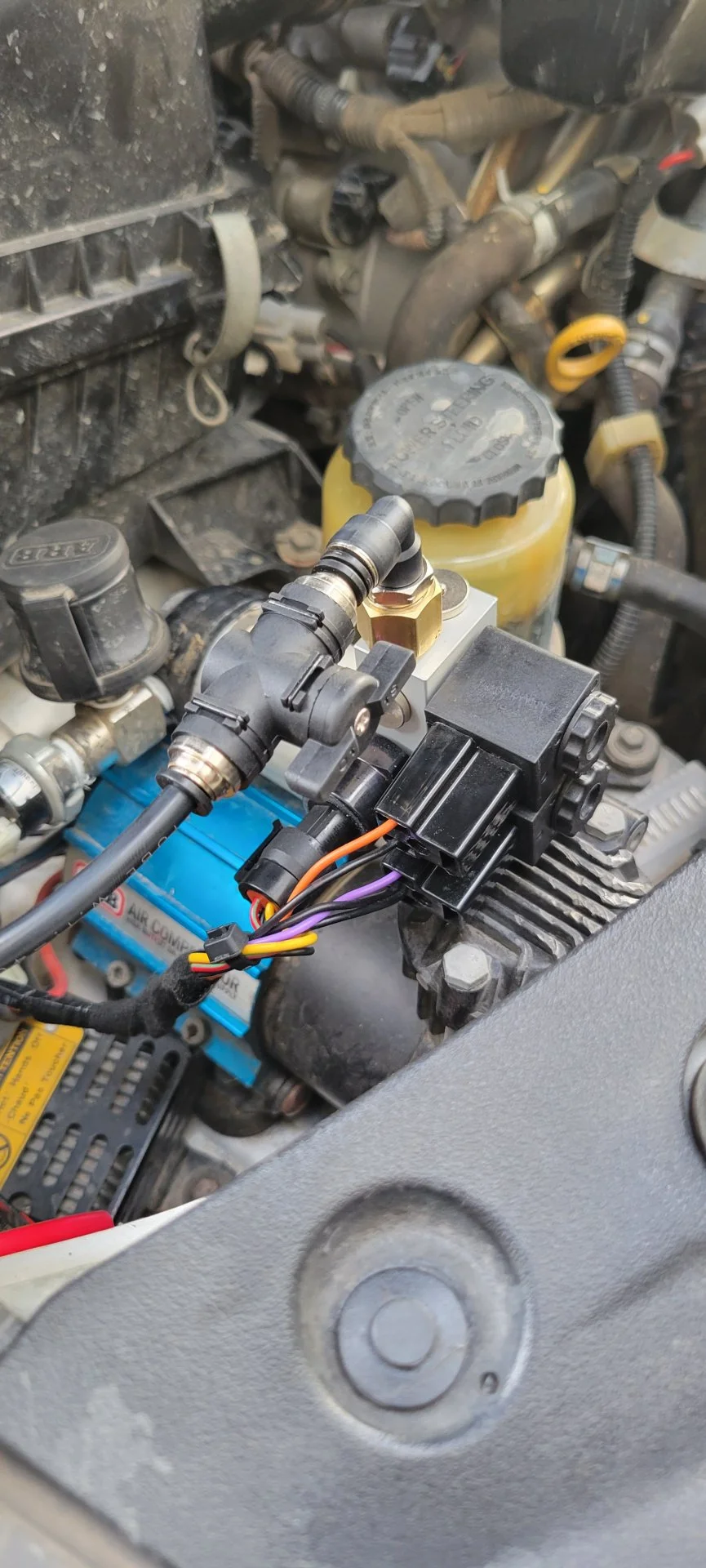

I agree, but I don't know if the juice would be worth the squeeze over their normal air bag spring helpers. If you have a air compressor I would just order the airbag helper kit and the ARB air compressor pressure controller so you can adjust bag pressure from your phone on the fly. Once you get off-road just drop the pressure and articulation is back. Also nice so you can set your desired tire psi and it will stop for you. No need to keep checking. (Please excuse the dirty engine bay :) )
