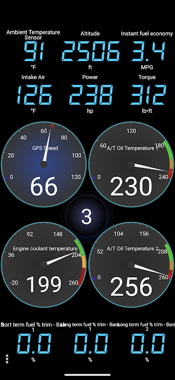

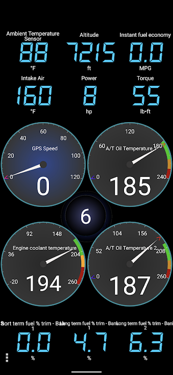

I generally find the same as @turbo8 that IATs track 5-10F of ambient. Except for two cases. Probably both helped by a snorkel setup.
When the engine is working hard, like really hard lugging a load hill. Heat probably coming off radiator. 91F ambient, 126F IATs
Idling or crawling in low range, IATs can soar. Here's slow crawling up a mountain - 88F ambient, 160F IATs.
