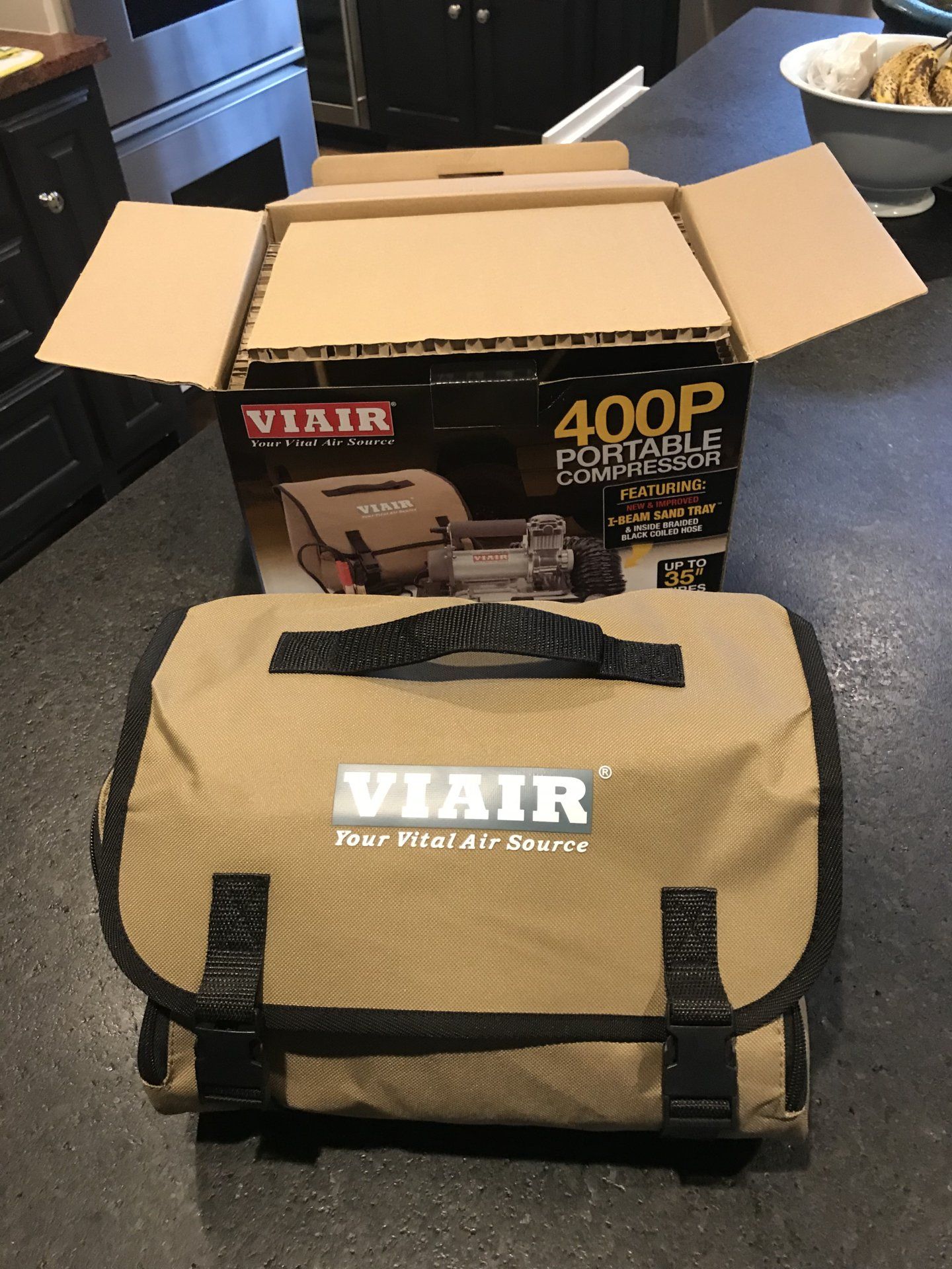

Upgraded to the 400P. I wanted the flexibility of going back and forth between my two LCs and also to take along with me in my John Deere Gator at the ranch. Should blow away (lol) the cigarette version I replaced it with!
My Superflow is in a very similar bag to that Viair 400P. It just sits in the trunk on its side and I slipped a bungee around it and the bottom of the 3rd row seat. Not ideal but I also have a Ryobi tool bag with a bunch of tools and recovery gear in my trunk, so the compressor is fairly small in comparison.
If you don't need the Toyota bottle jack you could try to store it in the jack compartment. The 400P might not fit but the 300 might. I have a small air compressor in mine actually that I bolted in for my helper air bags.
