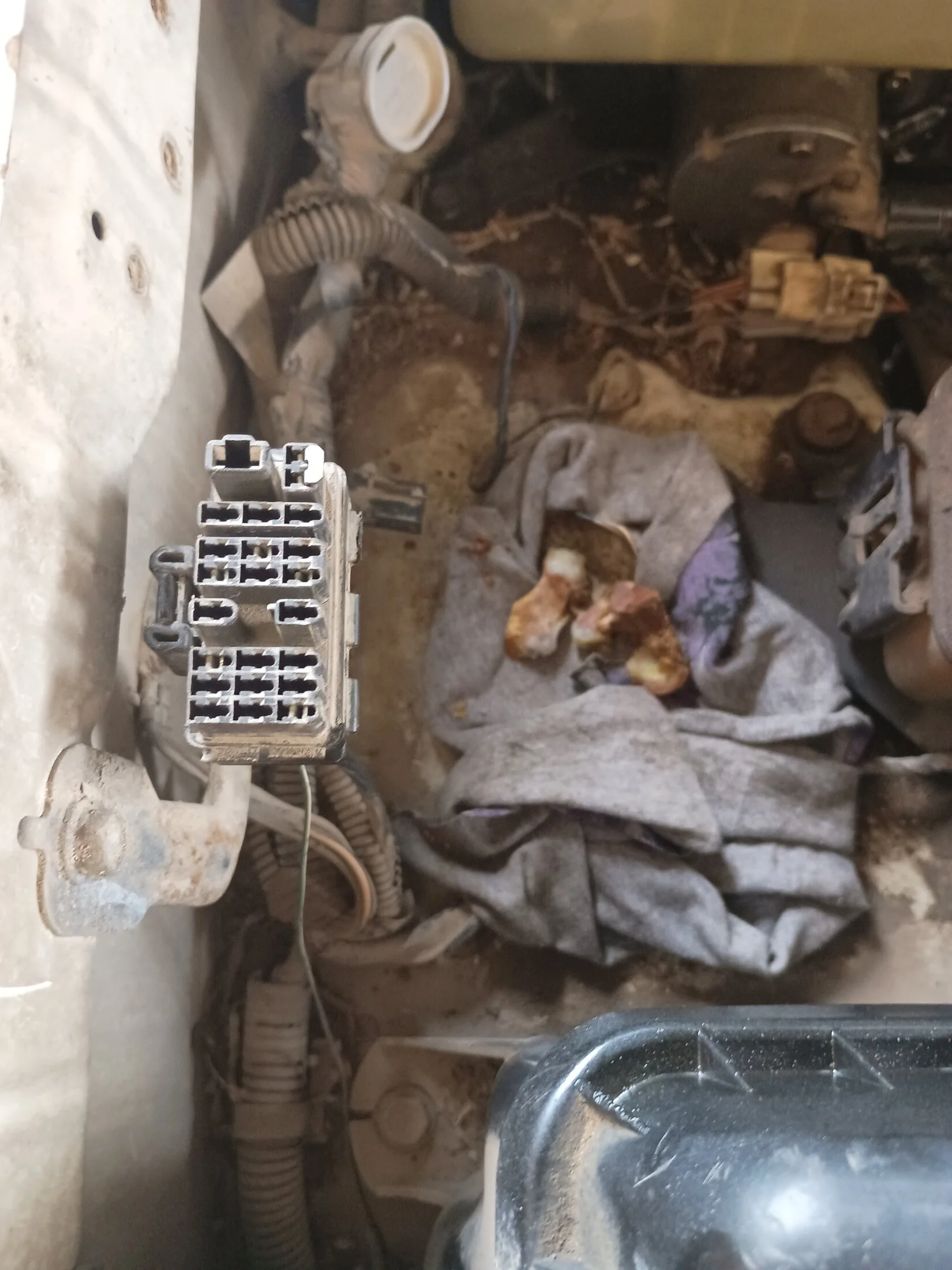

Vehicle was park more then 10 year some one stolen all 4 shocks and AHC module
Model is 2000
Any how now I reach to next level is ahc pump work for 5 sec and the dies
I m facing these issue due to there is no obd2 port in vehicle only obd2 22 pins available under the hood near ahc pump
And that port give me no communication I m confused
OBD2 port is under the dash near driver's knee - have you looked there? Are there any wiring issues (chewed by rats etc)?
I ve seen failsafe mod (flashing) a few times
