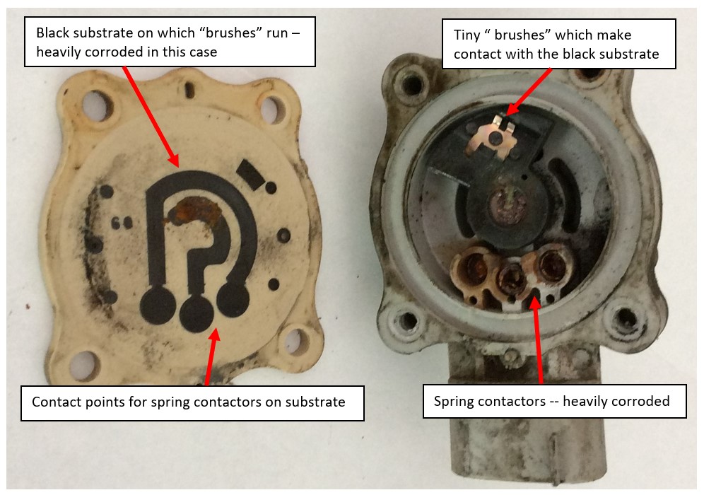

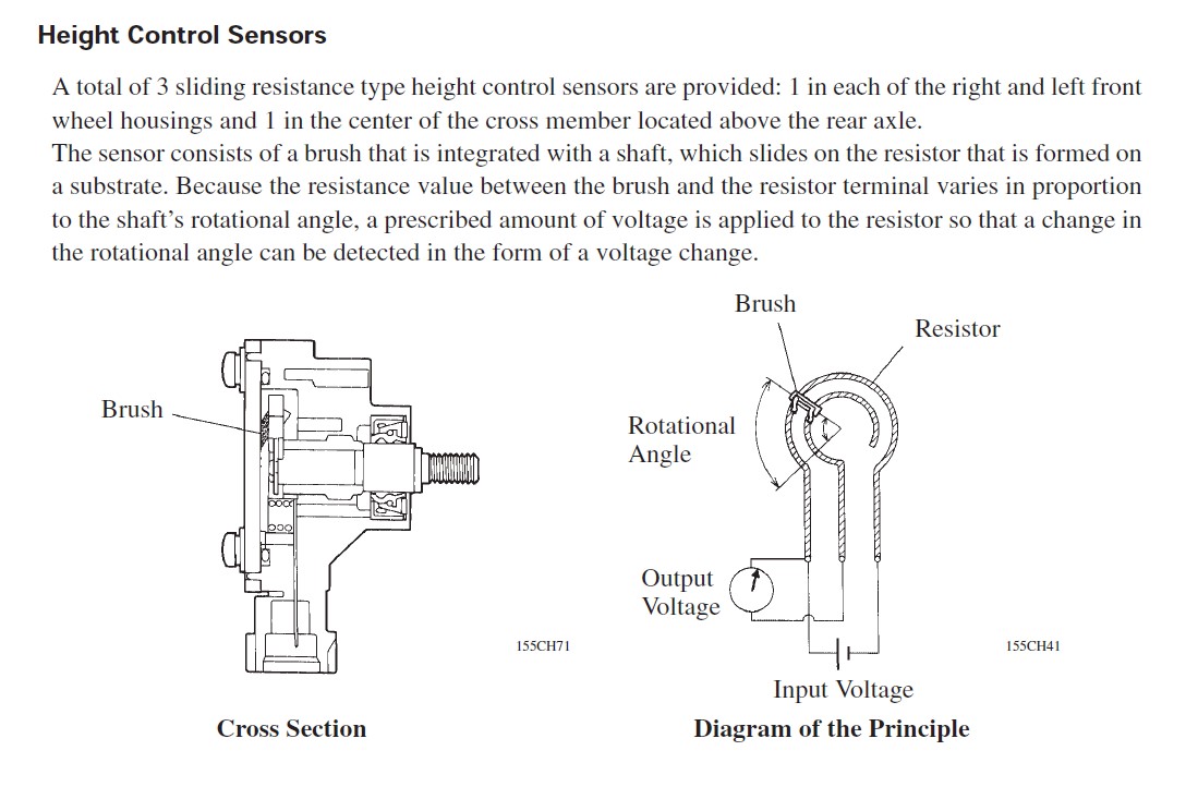

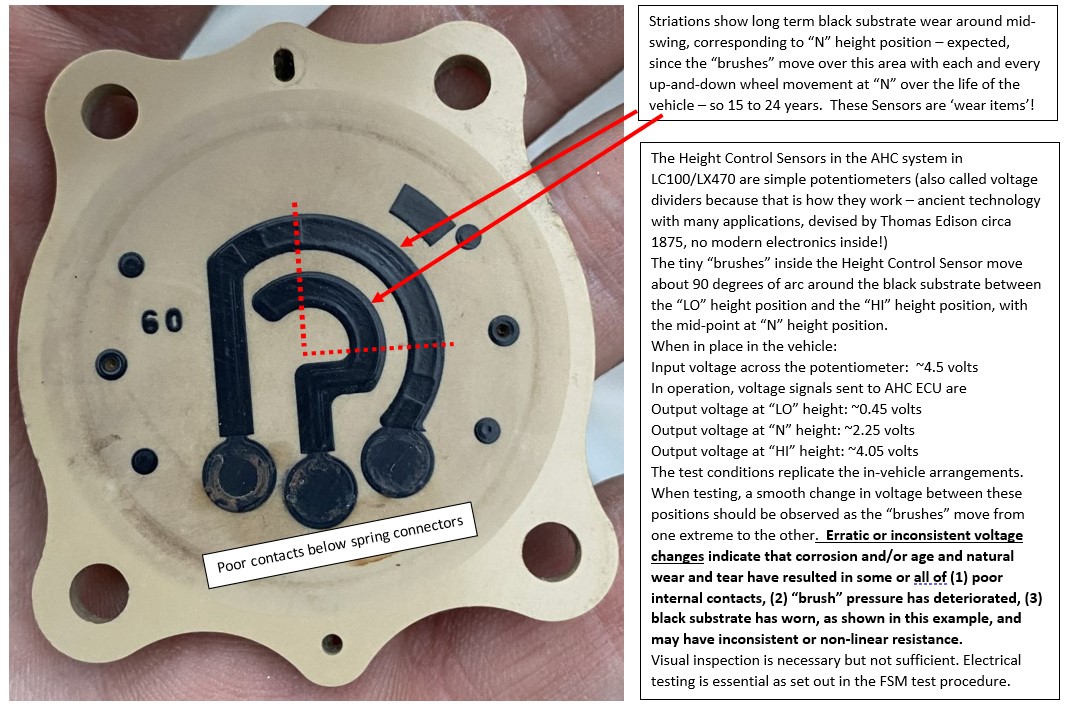

The Height Control Sensors are simple, long-life, robust potentiometers -- or voltage dividers -- involving an applied voltage and a variable resistance arranged, in the case of these Sensors, to be proportional to height. No modern electronics in here!! However, these Sensors are 'wear items', they do not last forever, and on any 100 series vehicle with the original Sensors, these items are now 16 years to 24 years old, and have worked continuously for every second that the vehicle has travelled. Their reliability is now low.
The DTC settings for these Sensor circuits are limited. If there is a DTC, there definitely is a problem. If there is not a DTC, it may easily mean that the voltage signal sent by the Sensor circuit is within the allowable range (so no DTC), but for a worn or degraded Sensor, it easily can be the wrong voltage for the actual height of the vehicle. In these very common cases, it really is only the non-conforming or inconsistent height behaviour of the vehicle which provides the diagnosis. The causes are wear and tear on the internal carbon track, weakening pressure by the tiny brushes contacting the carbon track, poor or corroded contacts within the Sensor, moisture ingress and 'tracking'.
These effects are well known and frequently discussed on this forum and elsewhere.

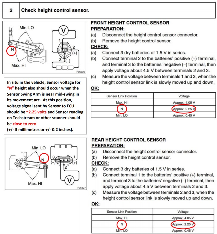

Problematic Sensors are common. Suspect Sensors can and should be removed and tested as set out in the attachment.
An alternative test based on resistances also has been suggested by @PADDO at Post #2 in this thread:
Theoretically Sensors can be cleaned up and re-fitted. For long-aged Sensors, this is a mug's game and replacement of ancient Sensors is the far better idea for reliability and no inconvenient surprises or unhappiness.

2. Check condition of Height Control Sensors – all should be close to zero +/- 5 millimetres or +/- 0.2 inches (AHC system cannot work correctly with faulty or incorrectly adjusted Height Control Sensors – absence of a DTC does not provide assurance of healthy Sensors),
If there is no reason to suspect Height Control Sensor problems -- such as erratic or inconsistent height behaviour at different times -- then assume Height Control Sensors and circuits are good, at least for now, and assume that there is no immediate need to investigate Height Control Sensors as described at Post #17 and Post #22 in this thread.
Techstream Height Control Sensor readings at Post #3 in this thread look reasonable -- a little low on the Front Left at negative 0.4 inches, likely because the Front Left hub-to-fender at 19.5 inches by tape-measure is physically a little lower than Front Right at 19.75 inches. This is reasonable. Some would say further tweaking is not worthwhile so leave it alone. Others would say tweak a little using the attached ‘cross levelling’ procedure and torsion bar adjusters with engine OFF to better equalise hub-to-fender measurements.
This also is likely to bring the Techstream Height Control Sensor readings closer to each other and closer to zero.

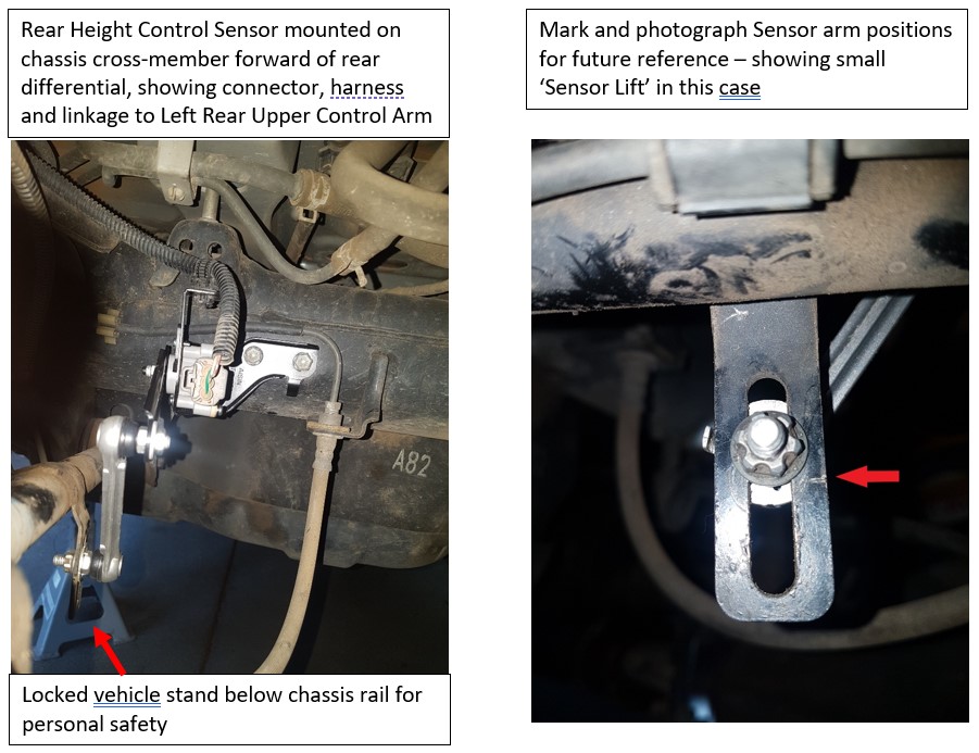

NOTE: Posts by @2001LC usually recommend minimum rake (Front lower than Rear) of 3/4 inch.
