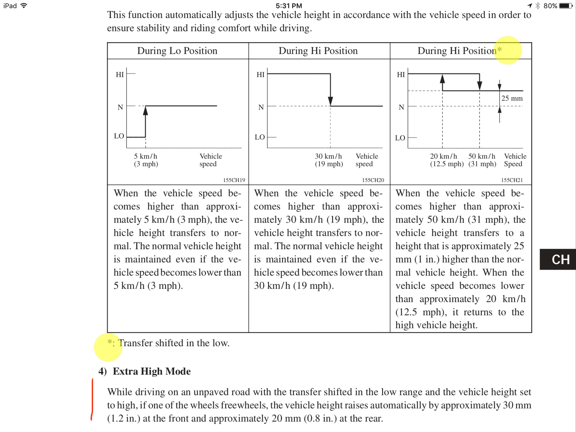

What's the fastest you can drive with the AHC setting in "high" Does it automatically drop down to "n" after a certain speed?
What about the low setting, does it raise the truck after a certain MPH?

I always heard 9 mph as max for Low, and 19 mph max for high.
Edit: Someone beat me to it, I assumed it was standardized in '06-'07 but I guess it was just optional.

I run 90% of the time in "N" when off-road, only switching to "H" when crawling. If you're able to move fast enough to drop back to "N" you probably don't need to be in "H."
Couple extra benefits of AHC when off-road:
- The "H" height is actual lifted height, not unloaded height like conventional. AHC will lift you up to the same height and keep you there regardless of load (assuming you don't max it out).
- "L" is very handy for ducking under obstacles while on the trail
- Extra-high mode. Gives you an extra 1" of lift when it senses wheel spin in 4L.
