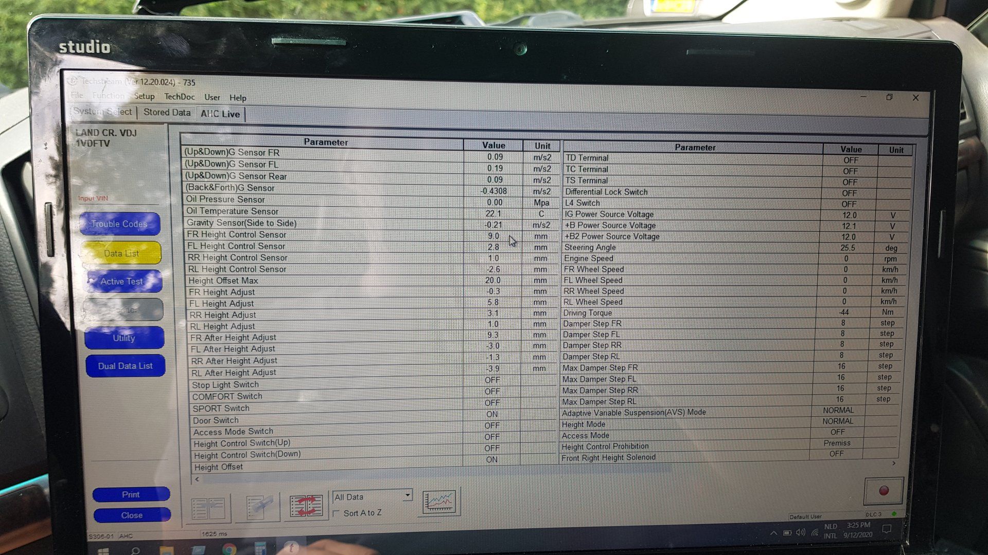

Through reading the very helpful AHC Sensor lift thread, I know that with 10 minutes in the driveway and limited tools, one can lift their LX a couple inches. What I am wondering, however, is what long term damage can be caused without changing data in TechStream? On the 100 torsion bars can help with the added pressure. What is the easiest way to ensure AHC reliability even after completing the lift?
