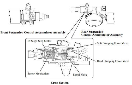

Funny you touched on spool valves.
We don't generally talk much deeper here than "AHC", it's Lexus association, and perceived connotations of mall crushing. The reality is that AHC is Toyota's tour de force mic drop for its vaunted Land Cruiser. Available as an LC upgrade option in international markets. Just that in the US market for the 200-series generation, it's tied solely to the LX. The '06 and '07 LC of the 100-series in the US did have AHC as an option.
What's interesting is that the AHC damper employs some pretty hardcore tech, including spool valves. But unlike DSSV and other static suspensions that rely only on analog magic to sense, AHC goes full computer control for continuous adjustment and feedback. So it's not only optimal for unladen use, but has the ability to dial in damping for much broader loads and use cases. So no static compromise has to be made. It's tied into just about every major ECU (steering, skid, 4WD, ECM, main body) allowing it to preempt and tailor. Actively adjusting for things like steering or 4lo, and further compensating for feedback of height , acceleration, and yaw rates. That's just damping. Heck it has 2 auto selecting spring rates for the front axle... what other system is capable of that? And there's still more to geek out on if anyone's interested.
Needless to say, I'm an advocate of the system. Sure, it'd be fun to setup a vehicle for fast Baja running. At a trade to better broader use. Though Baja setups are as much about weight, suspension travel, and other things that a balanced daily use 200-series isn't. For that, including durability, I have a hard time imagining better.
