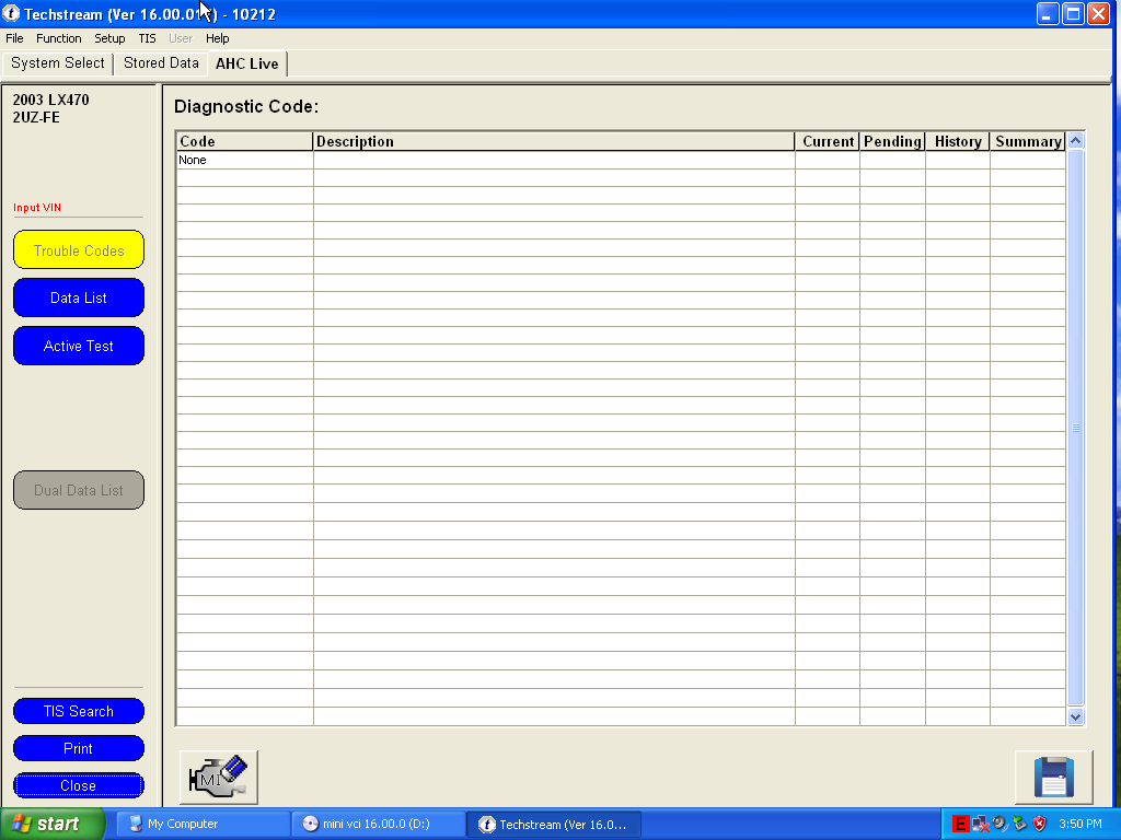

The whole car basically looks like it's butt is in the air - see attached photos. I can only attach 5 pictures here, so I'll attach the rest in a follow-up comment but the AHC fluid seems to be in a reasonable position and there is no code in tech stream.
The AHC lights would blink H or L when trying to raise or lower the car, but nothing would happen. Though when I hooked up TIS I see OFF under the height position lights.
TIS is reporting (see screenshot in next comment):
My guess was going to be that this is a height control sensor issue, but I'm thrown off by the 0.0 for the pressure sensors and not sure where I should start.
FR Height Control Sensor | -2.9 inch |
FR Height Control Sensor | 6.0 inch |
RR Height Control Sensor | 1.6 inch |
Front Pressure Sensor | 0.0 Mpa-g |
Rear Pressure Sensor | 0.0 Mpa-g |
Accumulator Pressure Sensor | 0.0 Mpa-g |
