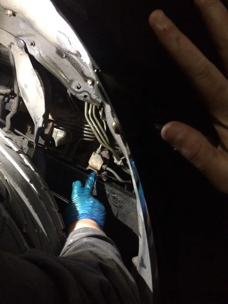

The fault is normally either inside the sensor (corrosion or worn carbon trace), mechanically of the linkage, or the cable next to either the plug on the sensor or the one on top of the fender.
Active test works but car will not raise up. Works meaning I can feel the pump running. Tomorrow ill probably clean that one.height sensor up.
If the pump is out of the car and I put 12 volt on it. Should the fluid shoot out or just come out slowly?
Right so the sensor itself is fine just the linkage broke I moved it around and on tis saw values moving etc. I set it to read the same as the other side still cant generate any pressure and getting pump pressure abnormal error. I'm thinking the pump has gone kaput! I'm going to remove it tomorrow and check the motor side see if everything is OK n try once more.

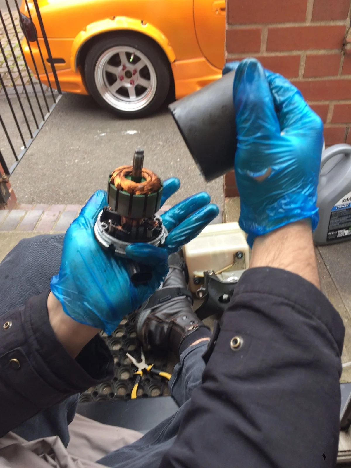

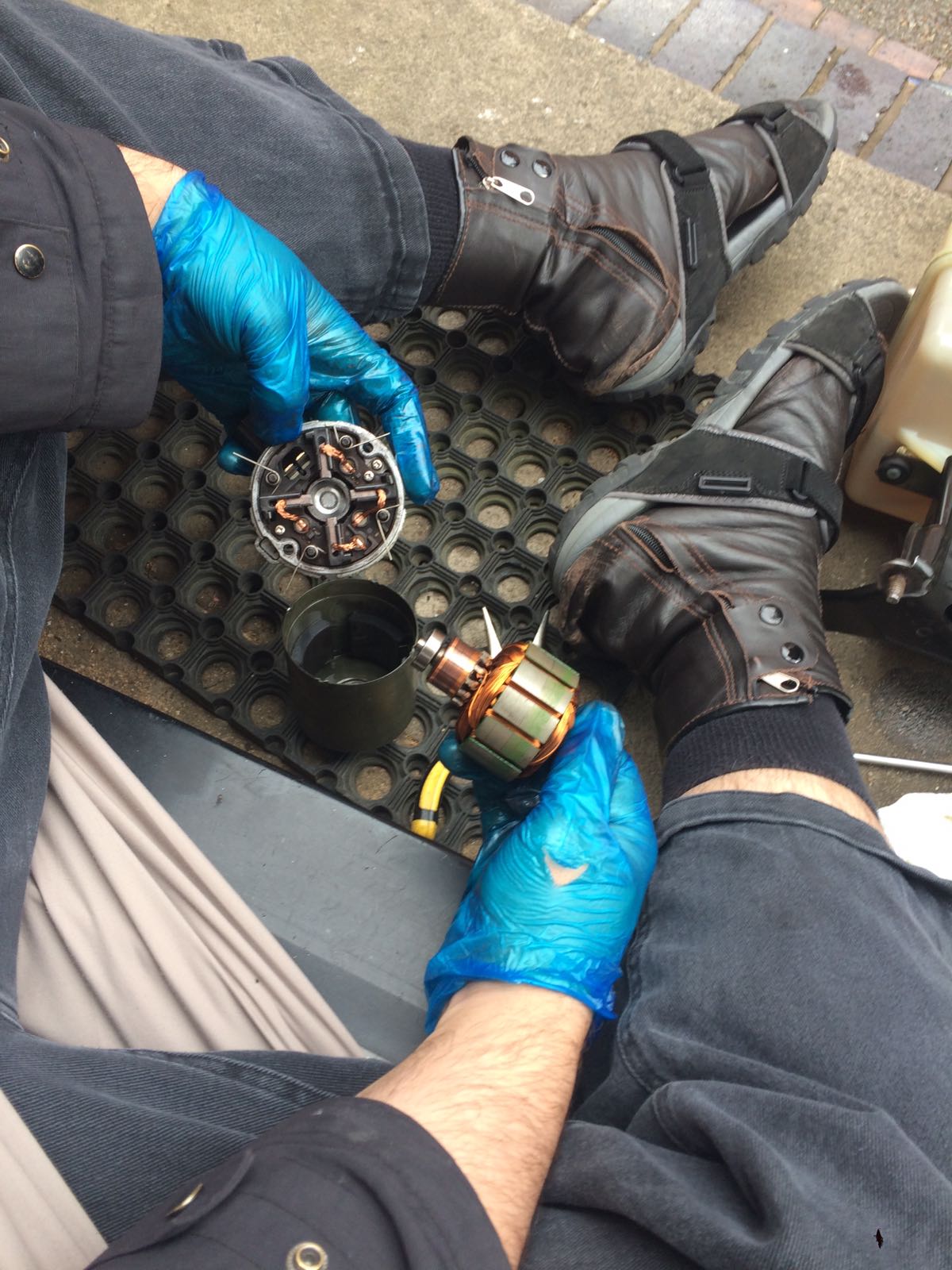

I tested the pump everything moving OK. Can someone possibly upload a vid of pump running so I can see at what pressure the fluid is supposed to cone out of outlet. I also bled the attenuator that seemed to have air bubbles in it. Should I bleed the control valve? I just cant get the bloody thing up.
Attached pump motor pics when was cleaning it out
