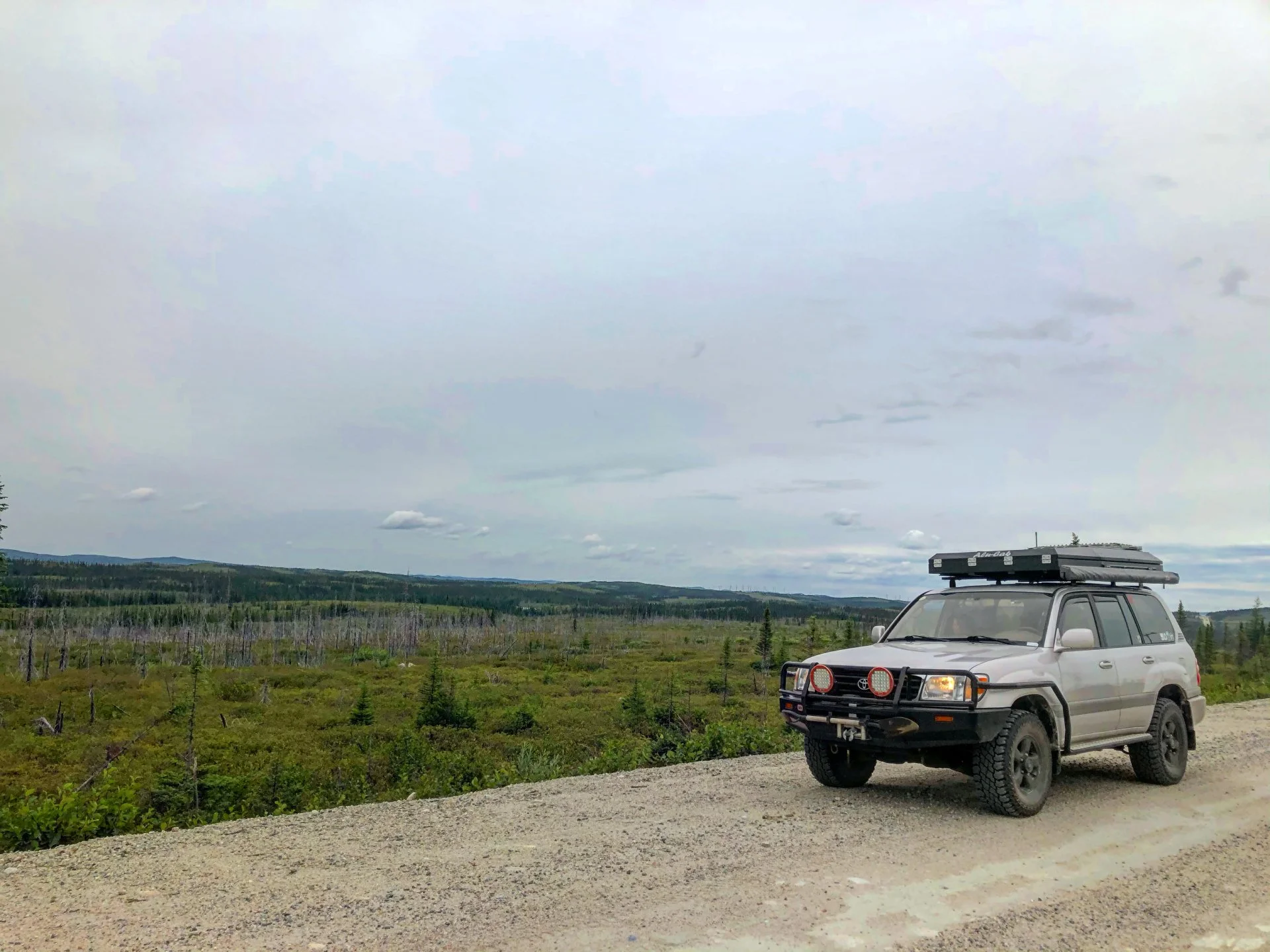

I don't have off-road bumper's or a winch on my AHC 100 but I do have sliders, roof rack, skids and about 30lbs of junk behind the 3rd row. My front fender to center hub is 19.75" and my rear fender to center hub is 20.5". My front AHC pressure is 6.4 Mpa and my rear pressure is 5.9 Mpa. I have AHC torsion bars and King springs. With the weight your talking about, I don't think the King springs will be enough for you, you'll probably need OEM non AHC springs and maybe a 30mm spacer.

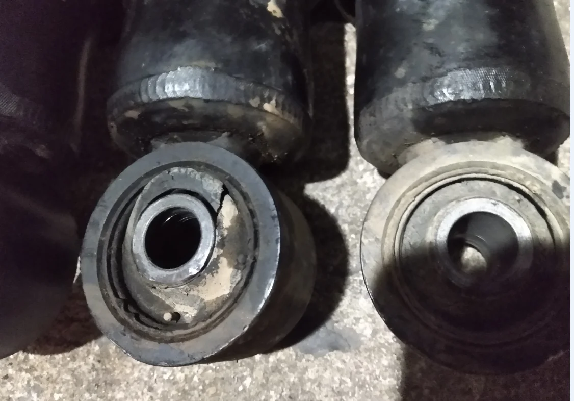

I’ve pulled two AHC out of these trucks. Both times the trucks were 01. The bushings on every single end of every single shock was beyond toast.
I agree the system is wonderful and works well, but all that is pointless if your rubber is shot. And I’d rather replace with regular suspension. Personal preference.
The rubber is my only counter to the “keep the AHC “ crowd, and it’s rarely talked about. But it’s a big one for me. And I’d rather not have a height sensor or something else go out a hundred miles into nowhere. I know that you can have things break on a regular suspension, but I’ve never had that happen on any vehicle I have owned, and I had a couple issues with AHC. Regardless of the reason. My experiences with the two.

If you are keeping AHC for the long term, check the lower mount bushings for wear and consider replacing.
With these type of bushings I'd imagine the whole shock has to be removed to facilitate getting the old out and the new in? These don't look to be ones that just pop out but need to be cut or pressed?
No experience with replacement. I photographed those after removing them for replacement.
