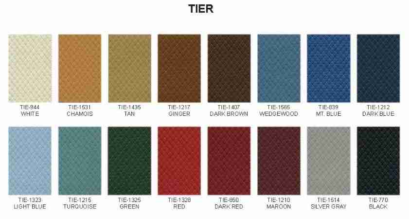

Cost of a bespoke replacement in Aus would hurt the wallet a bit. No idea if a matching fabric would be available.
Not sure if these are legit (and they certainly aren't cheap), but I found a few sites like this:
