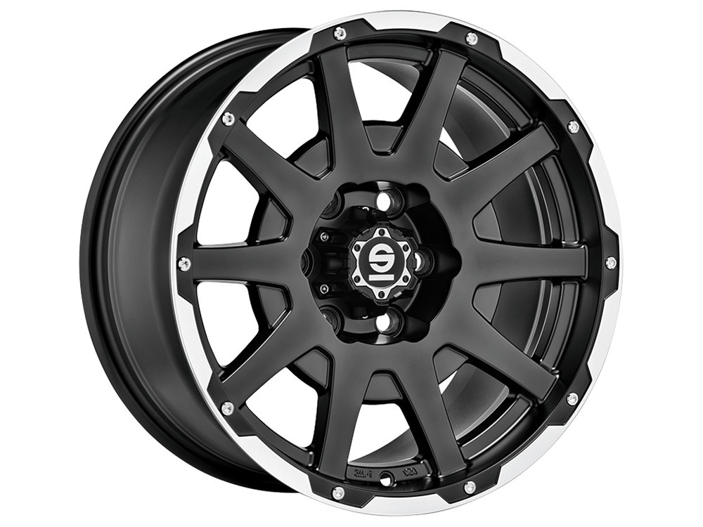

Well, I know it is one more thread about 35" tires but I try to find some answers. I think I read all threads on this topic but still have some shade conclusions.
It is a lot of saying about KDSS rubbing etc but here in Europe my car doesn't have kdss. Small chop, heat, bend in fender plastic trim is not problem for me. Tire sizes in Europe are not same as in USA. I can not get 35x12.5... the closest is 315/70r17 (34.4")
My 2012 LC200 has Rival front bumper, BP 51 with OME UCA (I deleted AHC), current OEM 17x8 ET60 wheels with 30mm spacers 285/70r17 tires. But I ordered Sparco Dakar wheels 17x8.5J ET25 and plan is to install 315/70r17. Hope that wont be problem with full lock at sway bar because no kdss... I saw in few threads that there is rubbing in UCA at full lock which is UNACCEPTABLE for me. I can not do Tundra swap in any case because it doesn't exist in Europe. At least not in my country. Does anyone have similar settings to mine with 315/70r17 tires and full necessary "to do" list. Can you confirm/deny UCA rubbing issue? I saw that 34"ish or 285/75r17 seems to be sweet spot. Should i stick to it?

A point that may help is that your setup and clearances will mirror those of the LX570 here in the states the most. As your rig was originally AHC, and as you mentioned you don't have KDSS, which will give you the best chance to fit full fat 35s.
My setup will be close to what you'll need to do for 315/70r17, that specs out to ~34.4" x 12.7". My 35x12.5s spec to 34.5" x 12.5". A difference is that you'll be running slightly more aggressive +25 offsets compared to my +35 offset. That'll put you really really tight, possibly just interfering against the upper fenders front and rear, where you'll need to roll/trim the fender a tad. And perhaps a bit of negative (-.5*) camber up front. Another strategy which you may need instead is to limit up travel to avoid fender interference. Or a bodylift.

Woow, you made a very detailed thread about fittment. Lot of things for keep eye on it. Two things worry me. Fender rolling, because we speak about millimeters to gain and UCA rubbing. Body mount and plastic trim seems fine to me. It looks like skinnier (285) tires work better to tuck in fender arch.
