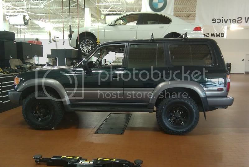

Hello. I am a new FZJ80 owner. I bought a 93' back in January of this year and have searched this forum high and low for answers to my problem. If I have somehow over looked my answer on a previous thread allow me to appologize in advance.
Here is my set up. 1993 FZJ80 with 150,000. American Racing 16" Tactic wheels with 285 75 16 Maxxis Big horn tires. All replacement parts have been with Toyota parts from Cruiser Dan or local Toyota dealership ,no lifetime warranty autozone type garbage.
Rebuilt driveshafts.
Birfield service/clean and repack
New trunion bearings
OME stock height replacement with shocks and steering stabilizer
Front wheel bearing service
New tie rod ends
Home frontend toe adjustment
Checked panhard bolt torque
I have highway vibes in the steering at 65-70 mph. I have road forced the heck out of this tire/wheel combo and still have the shakes. I have even taken to another spin balance shop and actually got a slight improvement in the ride but never the less still have vibes. Vibes/shakes come and go and seem to get worse (to a point) and longer in duration the longer I drive. I could also be my imagination but it seems to be worse after a hard acceleration like getting on the highway.

After putting up with this vibration for better part of a year and balancing my tires numerous times as well as replace almost every suspension and steering component possibly related to vibes. I stumbled on to my biggest source of vibration on the highway.
I was told the brakes on my 93 had been serviced prior to my purchace. I started noticing the familiar sound of metal on metal from my rear brakes. So I go in for the fix and find it unusual that the left rear outer pad is worn down to the metal while the inner is fine with plenty of pad material left.
I take my rotor in to have it turned and it was found to be warped too bad to turn. So I buy new rotors for the rear. I also found that one of the right rear brake caliper pins/bolts was bent causing the caliper to bind on the rotor and drag (this was a b!@#% to get out by the way).
After replacing the bolt and putting new rotors and pads on, I bled the brakes and put new fluid in.
To my surprise my vibes are gone except a barely noticable slight shimmy every now and then. It would now actually be tolorable on a long trip where before I could barely tolorate it on my 12mi commute to work every morning.
Just in case I did something else that may have inadvertently cured my vibe I did remove and reinstall my wheels and did unbolt my rear driveshaft at the transfer case and reinstall it after realizing I didn't have the grease I was going to lube my slip yoke with.
