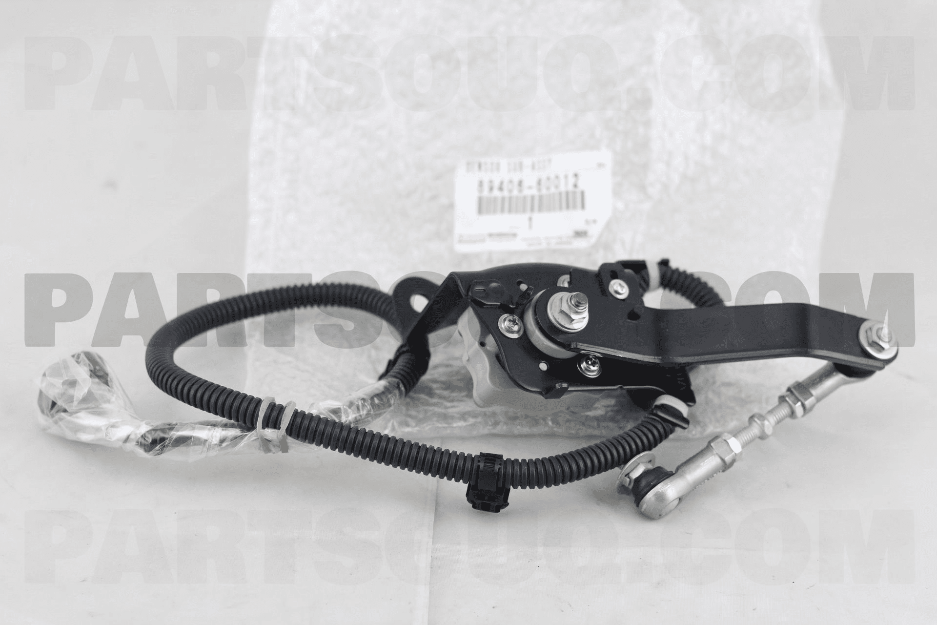

Does anybody have any experience with aftermarket height control sensors for AHC? Finding used OEM for 125-150 each and aftermarket for 50.

This is one of those times when the term "OEM" just doesn't cut it. In most circles (not Toyota forums) the term OEM would mean the Aisin manufactured, Aisin branded part from Rock Auto for $146 front and $162 rear. I would never buy a used "OEM" (i.e. OE) for $150. It might be only a week newer than the one you're taking off. The new genuine Toyota OE part seems to be around $350, which to me is crazy when the Aisin is $146.
But look at the part. It's indestructible except for the sensor itself. Have you taken it off and cleaned the sensor? It has been alleged, not really verified, that the sensor is just a Camry headlight level sensor like this one - Amazon product ASIN B072WQ8M3DIt sure looks the same. If your sensor doesn't clean up you should give it a try. It's only 22 bucks (clearly aftermarket). Take one for the team.

Not sure if this is the needed sensor, but this is a case where Partsouq makes a lot of sense. $209 vs $350, even at McGeorge.
