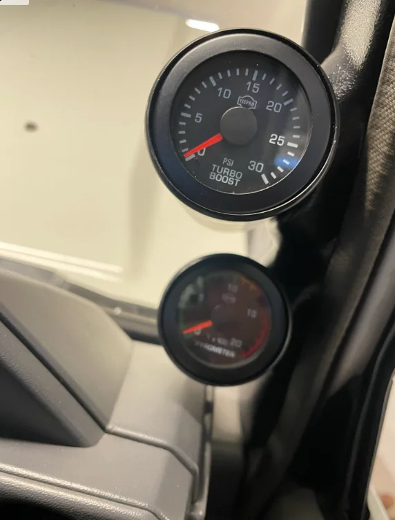

I'm a big fan of the pillar pod method. I don't like cluttering up the dash any more.
Wit-End even makes a grab handle adapter to add a 3rd pillar pod gage.

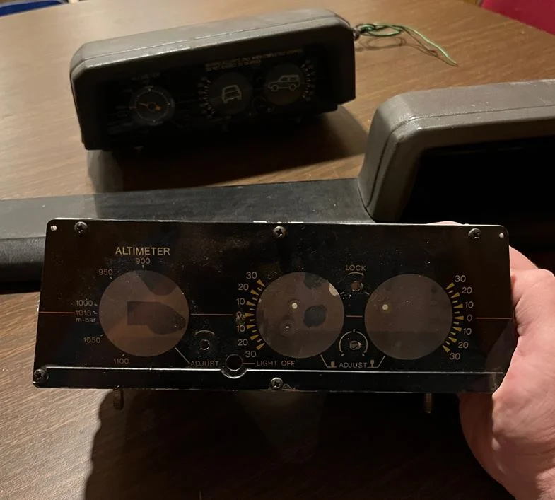

How are you mounting this into the OEM inclinometer pod? I have a couple of these pods sitting at my house now and your photo makes me want to use one of them for this. Just need to get the dash pad I got with it restored.
In mine, I used sheet metal to replace the inclinometer mechanism. Currently, I have only a boost gauge and an EGT temp gauge in mine which leaves me ample room for another gauge in the pod.
