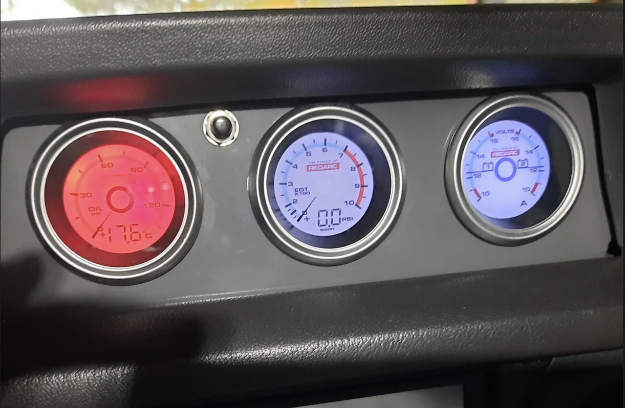

I’m running oil pressure / coolant temp, boost and EGT and dual battery. I’ll be glad to snap a photo in the morning.

** As is obvious from this photo I would never make it as a professional photographer. 😁
(Left to Right)
Oil Pressure / Water Temp. ( The gauge is programmed to turn red with low pressure or high temp)
Boost and EGT
Dual Battery (I have the hardware to add amperage and will do so in the coming weeks)
(Left to Right)
Boost and EGT
(Left to Right)
Boost and EGT
Dual Battery (I have the hardware to add amperage and will do so in the coming weeks)View attachment 3178144
How are you mounting this into the OEM inclinometer pod? I have a couple of these pods sitting at my house now and your photo makes me want to use one of them for this. Just need to get the dash pad I got with it restored.
The shop uses a fairly rigid plastic material to make up the face of the pod. In my case, 3 holes for the instruments along with 1 small hole for the programming button.
L shaped piece of aluminum, with maybe some stiffeners on the ends where you would run the attachment screws of the cover?
I was thinking of using the original internal housing with the faceplate blacked out and cutouts added but I don't know how much depth aftermarket gauges would need.
