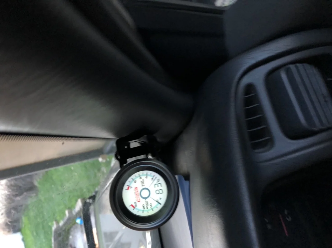

Redarc in Australia do some really nice gauges. I’ve got no affiliation with them, just like the way they build things
That’s my EGT, Boost and coolant sensor gauge. It’s a remote head so all the brains and weight is under the dash.
They do a lot of different combinations.
The gauges come with sensors plus they have optional ones
