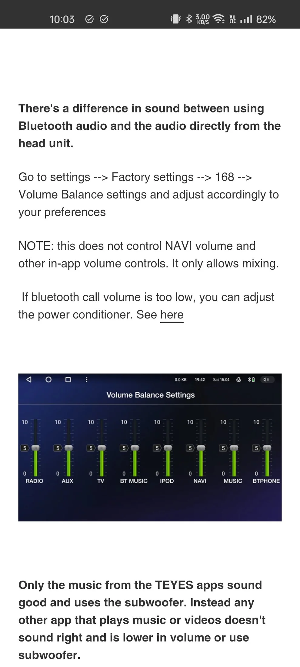

Also, I was looking through the official T'eyes troubleshooting post and came across this - maybe your source levels could be adjusted?
I wonder what T'eyes has to say about that?
I came across the same thing. I tried changing the values, but it made no difference, sadly. I've reached out to Teyes tech support, and we will see what they say. For reference, I purchased mine in 2022.
After a lot of testing I figured out depending on the app you use you will get different RCA voltage. The default built in audio app gets me a full 2.6v with no boost. I'll see if Teyes has any recommendations on this.
