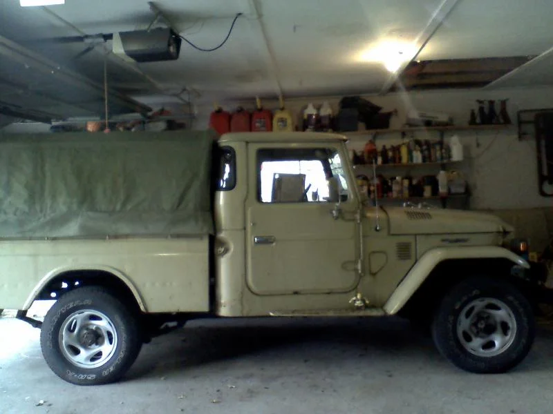

Nice find. Where did the truck come from originally?
I don't think it is a Canadian model as there are no side window heater ducts.
Put me down for a 45 run too.
I am not sure if it was a Canadian truck, it is in miles but I just thought it was old, lol The truck did spend some of it's life in the NWT... I am assuming that because it had a NWT license plate on the front when I got it. What do you mean by vents :confused:
Thanks 45kevin for the guidance to start finding parts :)
A 77 will not have the side window heat ducts. That started in 78. Also the speedometer should be in miles primary and KMs secondary as I have also found that the opposite started in 78 as well.
my new to fj45
OK guys I went outside into garage and took a picture of my new to me fj45 77 pretty dam stock surface rust only

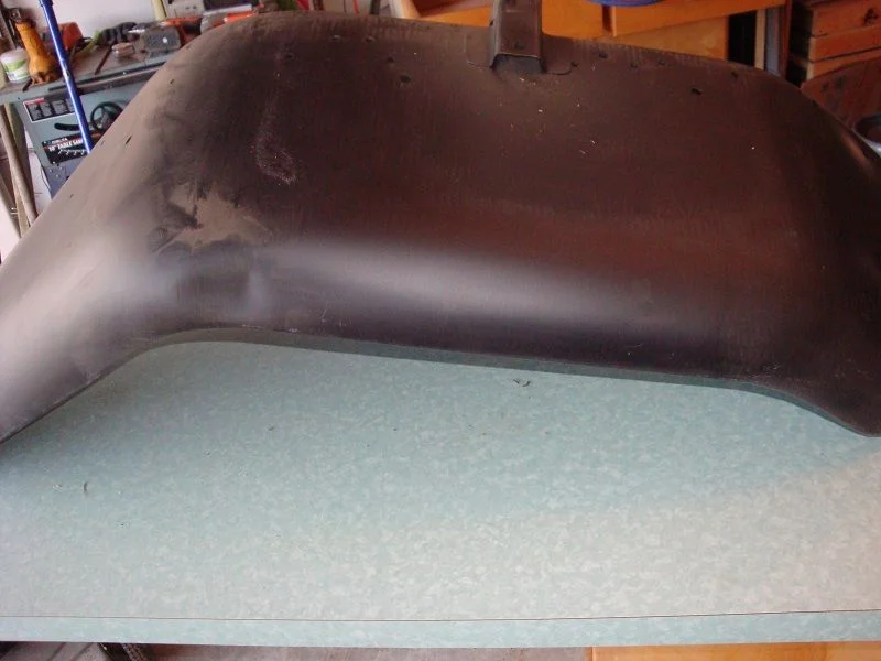

I have a pair of aftermarket fenders I got with my truck too if you'd want them.

You can have them with the caveat that you use them on your rig. I don't need them as my fenders are in great shape with only a little of rust around the signal lights. These fenders are aftermarket as I mentioned.

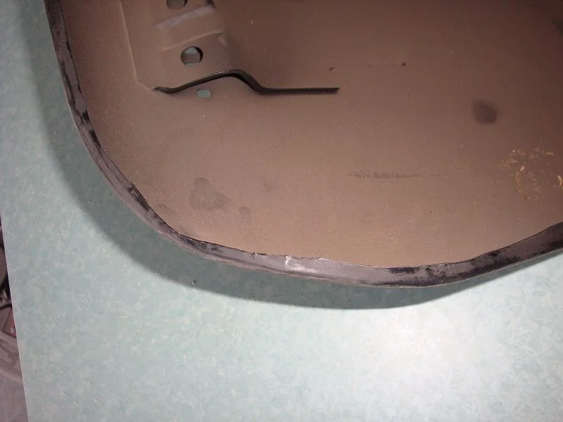

They are not exactly the same as the OEM, but I don't think anyone will notice unless you compare them side by side. The main difference I found was on the lip under the fender. The OEM lip is much smother, whereas the aftermarket ones seem more pieced together.
I also have no idea of what the fit is like, but from what I have been told is that they were purchased quite some time ago so maybe the are better quality than what you can get now.
It looks like one has a bit of a dent as well.
