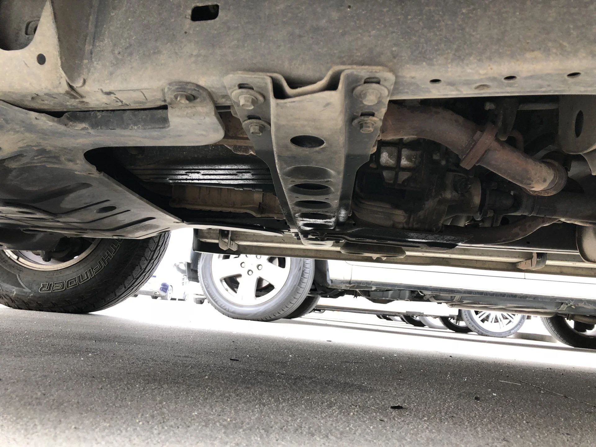

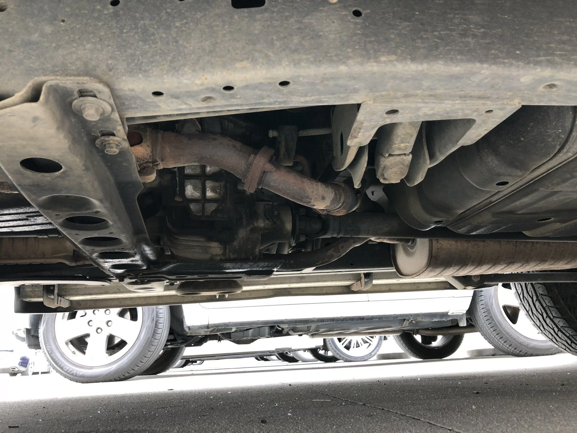

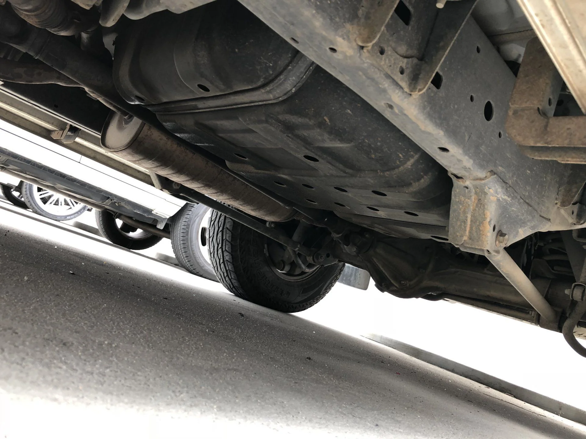

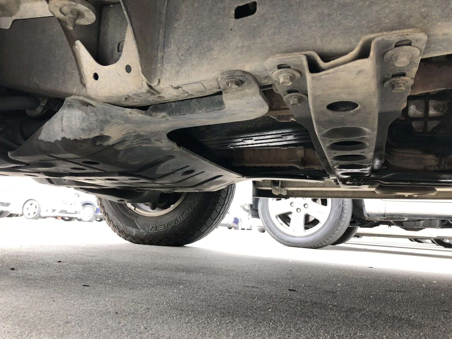

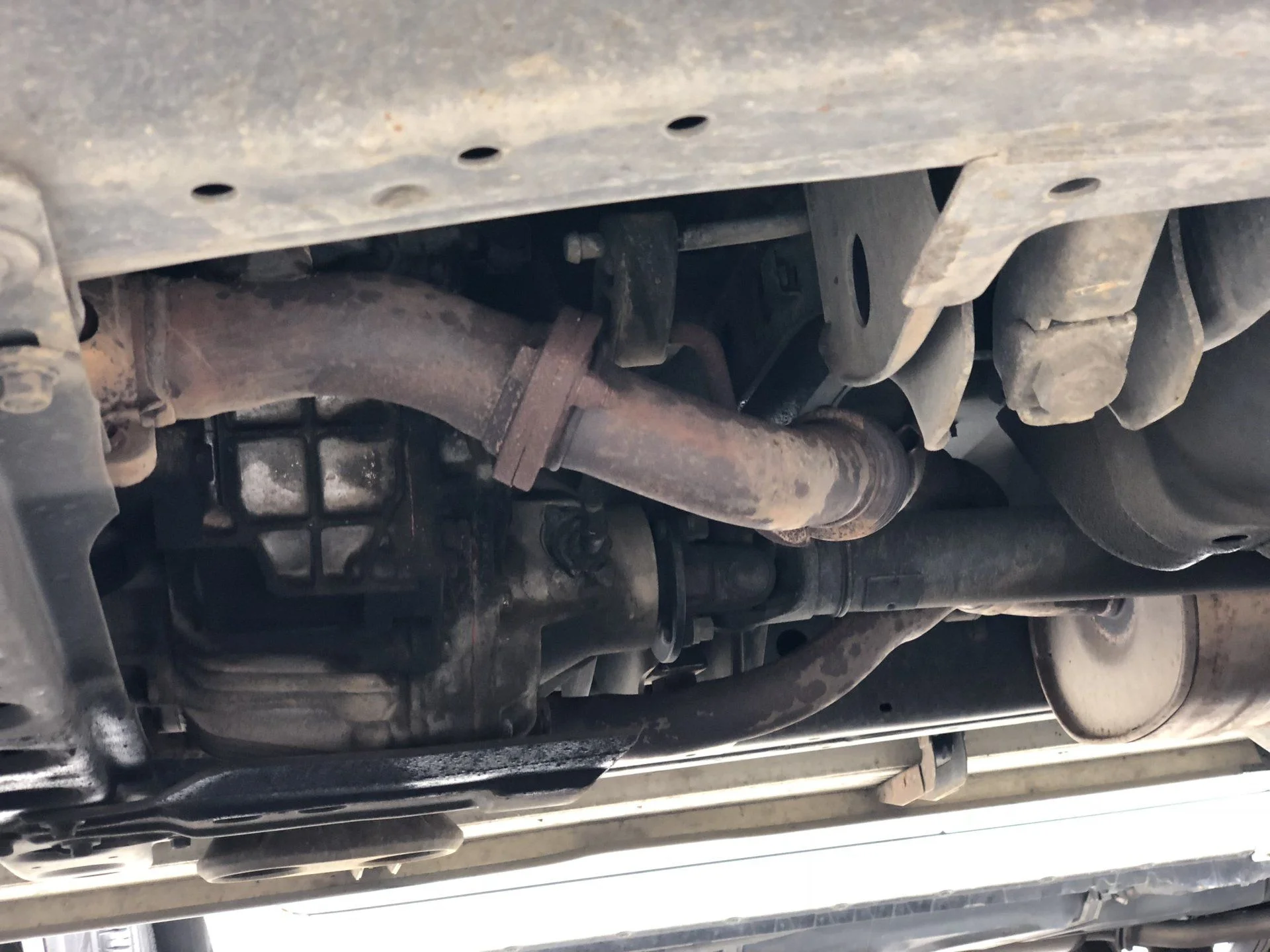

Here are some photos of the underneath of the truck.
Looks pretty clean . . .
At $3500, its probably gone by now, that is a steal. It probably leaks some oil. So you go and buy it?

I'd buy it for 3,500 based on the first pic of the undercarriage. PPI? It's not a Lotus. Is this truck located near Washington DC by chance?
