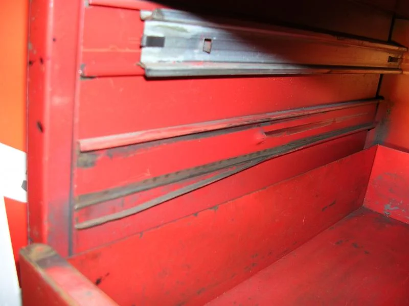

Just noticed that one of the drawer rail of my old mac tool box had broken off (see picture below). It is a very nice box and I would like to get it fix (if possible). As I don't have an access to a welder, I am wondering whether there is other way to fix it such as gorilla glue. (the rail is not completed broken off, it is just about 6" from at the front end.)
Thanks in advance for any suggestion.
and bolt up small piece of tin bent on a 90 for the bottom of the drawer to ride on . the upper h ook will keep it in place
the bottom sheetmetal will support the weight.
Thanks for the advice. With my buddy's help, we did just that and it works very well (except it does not slide as smooth as before, but I think it will get better once I grease it up). :cheers:
