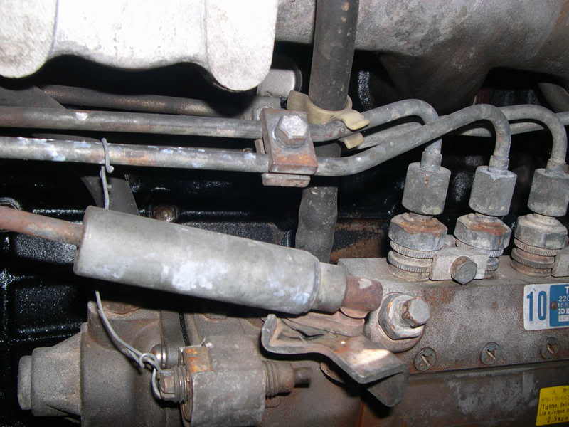

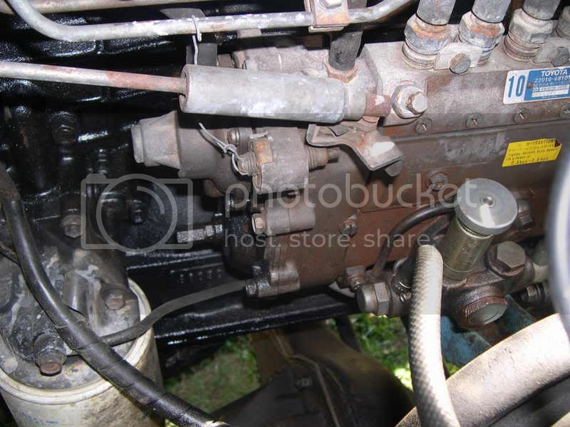

I have a 1984 Troopy with a 2H and need to check and see if the inj. pump was turned up by the prior owner. Can somone post a pic of the correct screw to turn the fuel down? I get lots of black smoke when I am getting up to speed or pulling a grade.

that's the screw with the wire through it.
How long has it been since your injectors were rebuilt? There is no point in turning the pump down if the injectors are leaking or have a s***ty spray pattern causing it to blow smoke. I would look to the injectors first.:cheers:
Thanks for the PICS. My 2H has 300,000KM+ on the engine and don't know any history of it..... I should probably start with the INJ. first and then once they are good move to the Pump Adjustment. Thanks for your input...
I'm not sure on the 2h, but I thought they came with a lead seal on the wire from the factory. So if the wire looks like it was cut and adjusted, then the lead would be gone.
