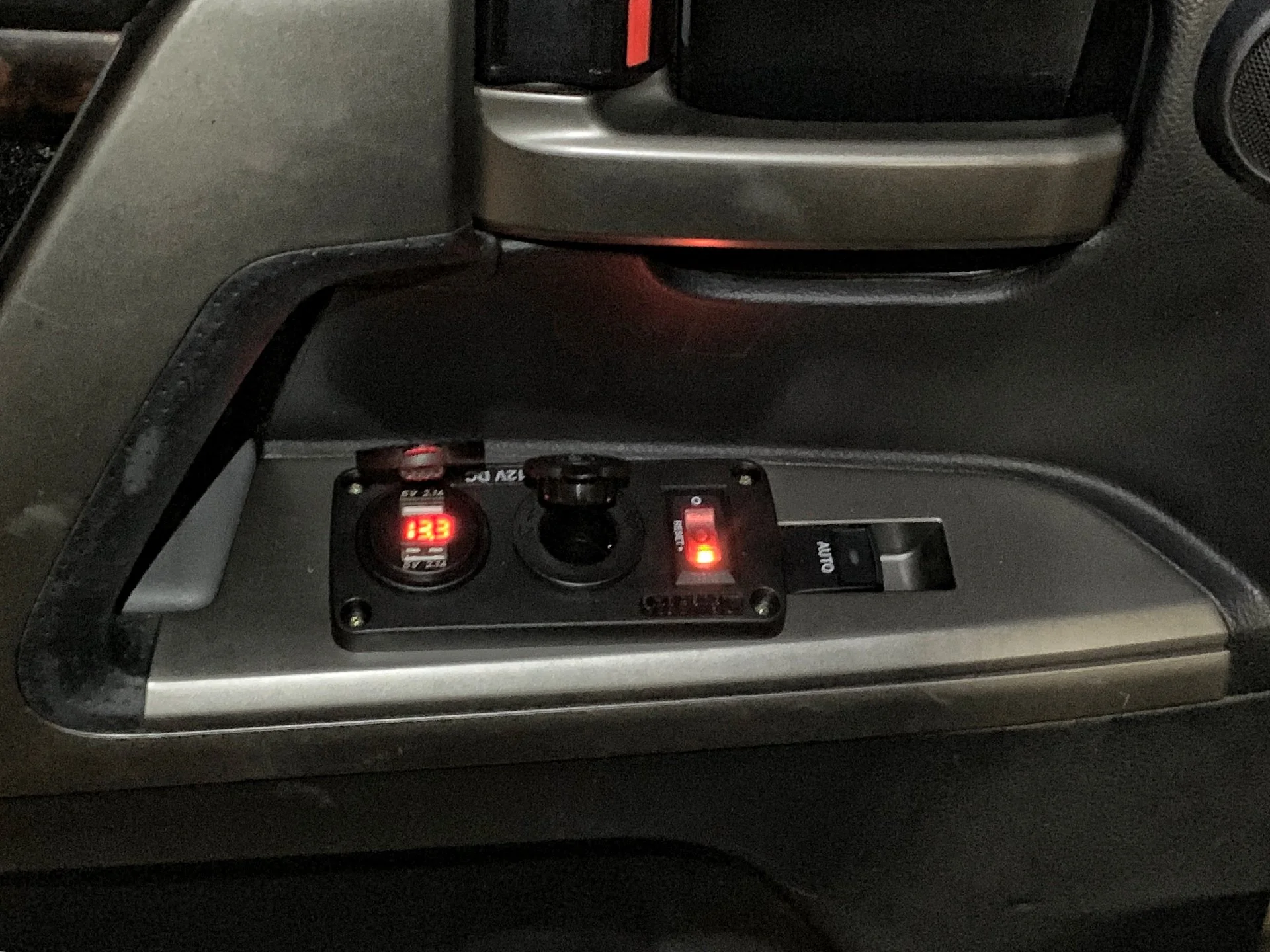

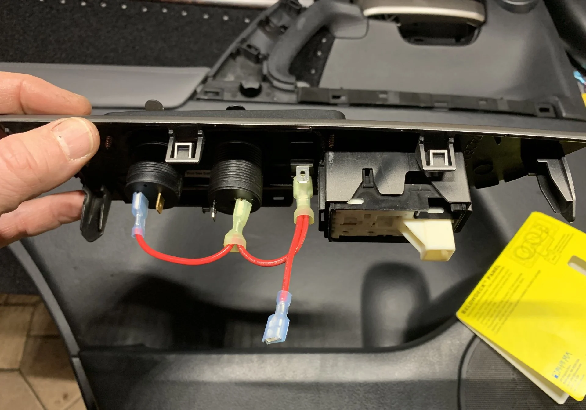

Ya. USBs come in a massive array of amp/watt output for sure. I have a zillion USB add ons in my truck (a zillion is just barrly excavrraging) ranging from 2.1A up to much high power USB-C and also full-power-capable Qi levels.
The cool thing about these 12v sockets is how easy they are to replace as new connector types come along.
Here’s one of many examples in my 200. I no longer have the 12v outlet…replaced with a double USB and a USB-C…but lots of possibilities…
My 2nd row door example is tricky, but in other panels, a hole and wires to the front are easy for various hogher power USB types.
