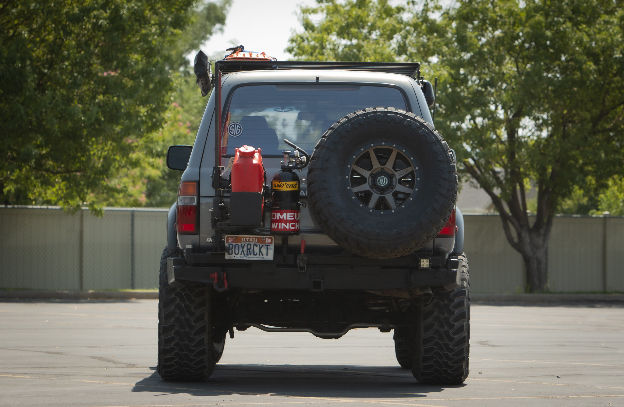

Since switching my tires from 35's to 37's I've got a minor issue where the spare tire on the swingout now partially covers the taillight and blinker. I've spoken with a LEO friend and he assures me it's not a problem legally. However, I notice that when I'm turning right (the side with the blocked light) that cars behind me don't always see that I'm planning to turn. So I'm going to add some secondary brake and blinkers to the rear bumper. I'm looking for some recommendations for some good lights, incandescent or led, that are waterproof and decent quality and also look good and appropriate for an 80. Any tips for wiring these would also be helpful.
If you've got pics (and better yet, a link) of some lights you'd recommend, I'd love to see them.
IMG_4951 by Adam Tolman, on Flickr
They make little 1" round amber or red LED that are surprisingly bright. Would be easy to install. You can find them on Amazon or I get them locally at Six States Distributing if you have one near you or maybe just about any place that supplies trailer parts.
If I don't find something that looks like it "belongs" on an 80 then it might just end up being the little 1" ones.
