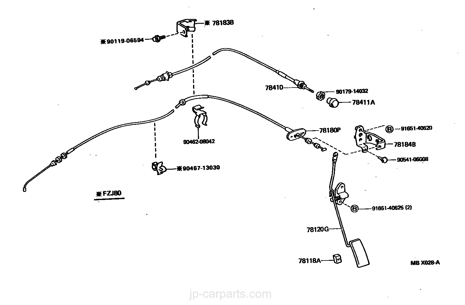

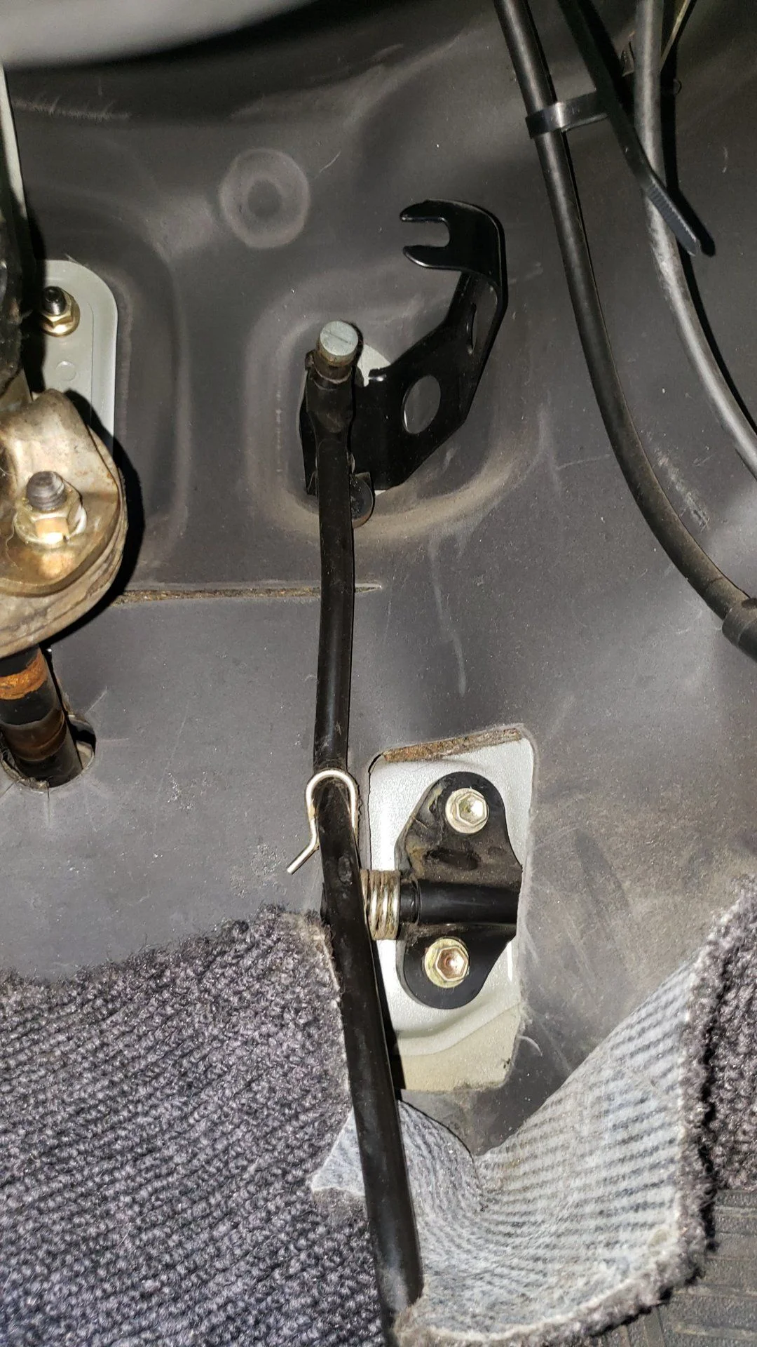

My accelerator Pedal can move from side to side about an inch, and seems to be loose on that bracket that secures it. The accelerator cable also seems to be getting worn... I'm not sure what it's supposed to feel like as I haven't driven another 80, but all the other cars I've driven have had much easier to control accelerator pedals. I was looking into replacing the whole pedal to take care of the side to side movement as it comes with the bracket that it seems to be loose from, and replacing the cable to make it smoother. I believe the part number for the pedal is 78120-60070 but can't figure out the proper cable part number. There appears to be two in the diagram, while my 80 only has one and the bracket where the second one would sit isnt populated. Let me know what you think about this.
