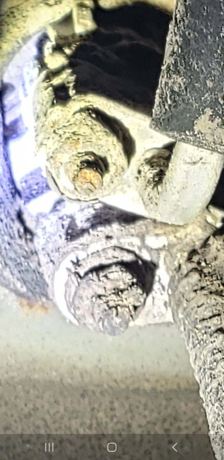

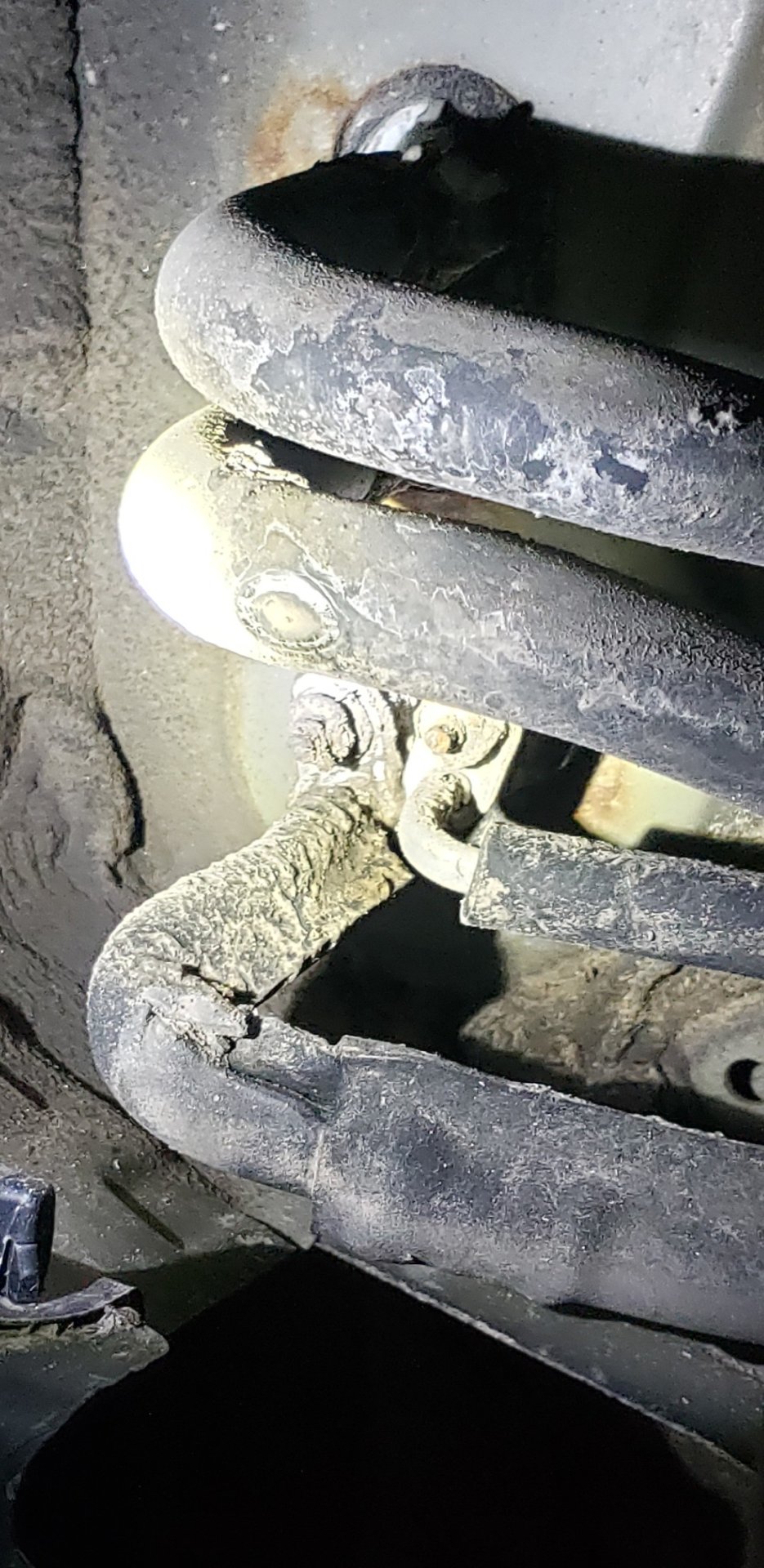

Just got back for a long drive through the desert down south and ended up with a pinhole refrigerant leak in one of the AC hose fittings by the drivers side rear wheel. The leak is in 0ne of the metal fittings between the hose from the front and the rear floor. Toyota only sells the hose and fittings as a complete unit, and it requires the transmission and the exhaust to be dropped to replace. Anyone have this issue before? Are those high pressure or low pressure hoses? Checked everywhere I can online but only found similar issues with Sienna minivans. Considering trying Flex Seal rubber sealant to the fittings to see if that works.

The weird thing is, once I blasted all the crud off the fittings look like brand new. But it definitely a pin hole leak in fitting given where the dye is coming from. Frustrating as it will hold a charge for now but I know it will leak out again. Hoping it is a low pressure line and that a spray-on rubber sealant will patch it as I’d rather not spend thousands to fix an easily accessed but hard to repair part.

The white glowing area in photo 1 is where the UV dye indicates the leak. It took about 6 weeks of using the AC all the time after a refill to leak that much dye. When I power washed all the road gunk off the fittings they look like new.
Not sure which one, if any, is a high pressure or low pressure line.

It is in the metal connection. The line is fine. Challenge is the hole is so small neither the dealer or could find it. Hence the recommendation to try Flex Seal.
Possibly stupid question but could it be the o-ring fitting at the end of the line? I say that only because mine blew out when replacing the carpet
