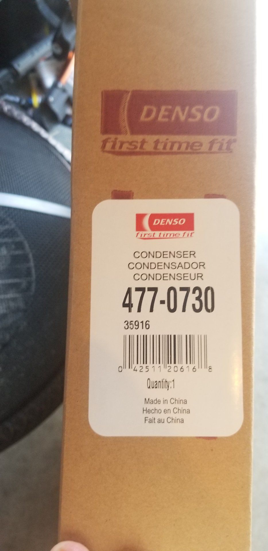

Don't always trust the online part config/compatibility checker..... Good news is I think I found my AC issue. Bad news is, the frigging Denso part I ordered to FIX it Doesn't fit. BTW, I live in Hot Ass Florida. And it's Hot as the Devils balls already. I THINK this one is for NO REAR AC, which...Did the LC even come with No Rear AC option?
FML
Correction- it IS listed as a NO-REAR AC part.......just buried deep in the description for the part Ad. Be sure to read every line when you order parts.
STUPID ME.
At what this costs, my wife is going to cut off my nuts.
You need Denso #477-0603. Denso's website doesn't tell the difference between the two. Rock Auto $133
Thanks, Ordered! Still...Damn.

Rear ac was an option in 1999. It was not available on the 1998 Toyota Land Cruiser. It was available on the 1998 lexus lx470. In 2000 rear ac was added as standard equipment. These are US spec vehicles.
The old condenser. Definitely, my issue was leaking condenser.
