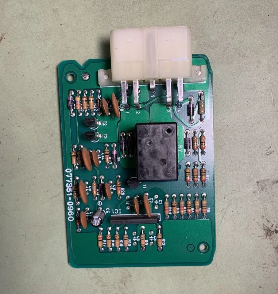

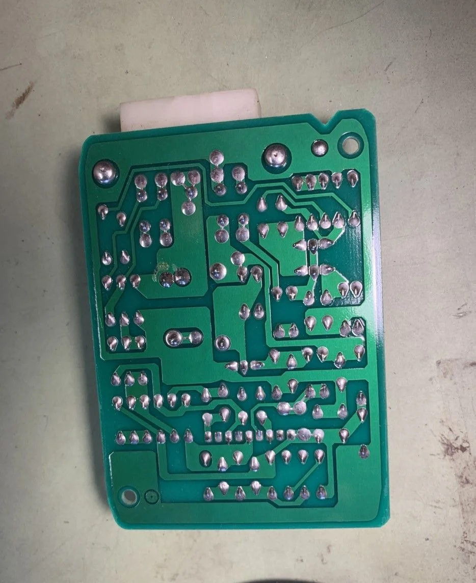

The a/c shop thinks the amplifier is the culprit. I replaced all a/c parts last year. Everything worked great... then the compressor suddenly would not engage. I can bypass and the compressor engages fine.
My question is... How do I test the amplifier? Here's pics of the internal circuit board. It looks pristine.
Any help is much appreciated! Thanks!!
