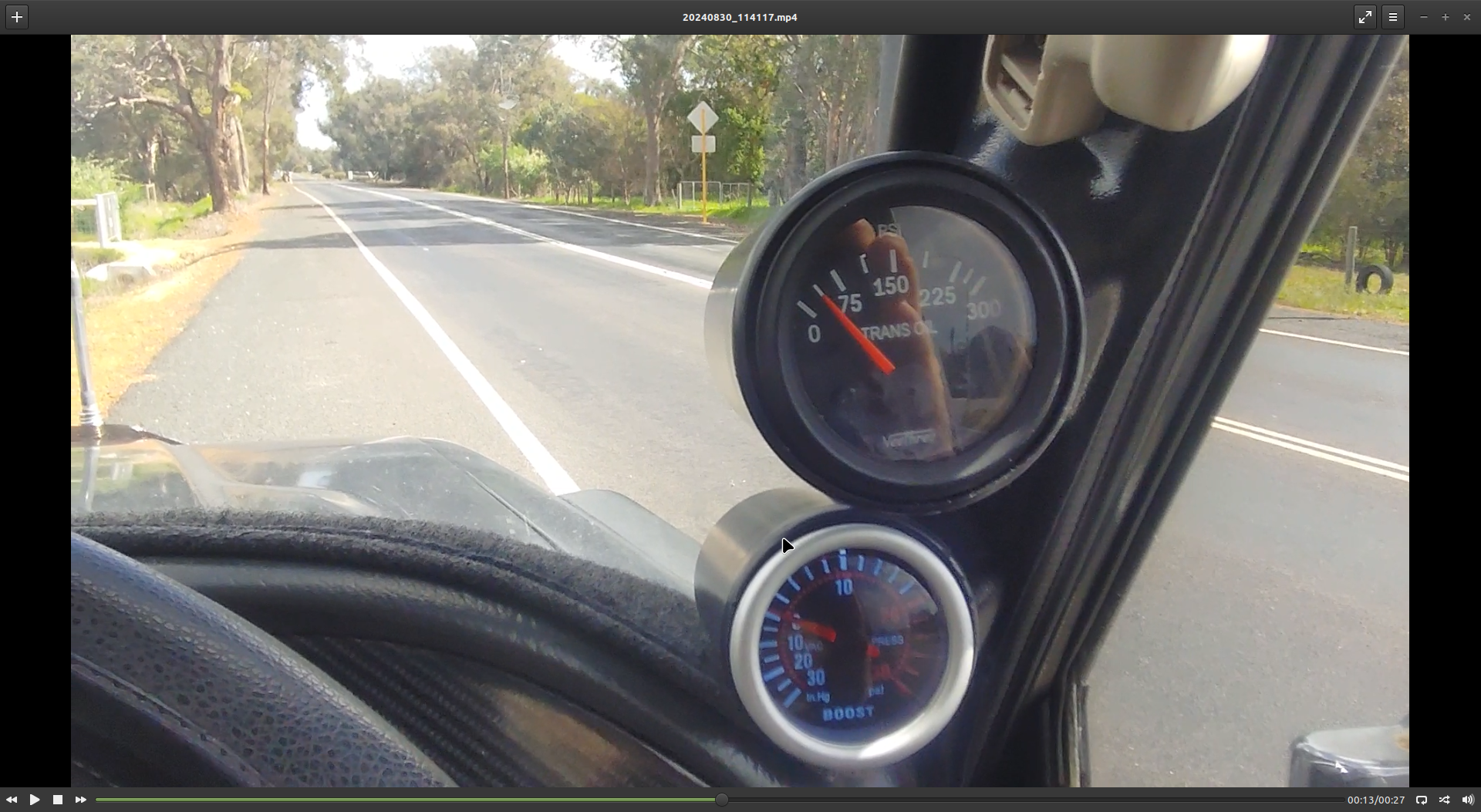

After several months of getting the run around I finally have another shop that is helping me with this.
The fitting of the transmission pressure gauge helped diagnose a pump fault.
Line pressure is well below specs and therefore not enough pressure to maintain lock-up
TC over heats. We are now looking for a pump.
fitting the gauge was easy, port here: FJ62 A440F Trans Rebuild - https://forum.ih8mud.com/threads/fj62-a440f-trans-rebuild.678364/post-8277590
I fitted an 80 series pillar pod to house the gauge.

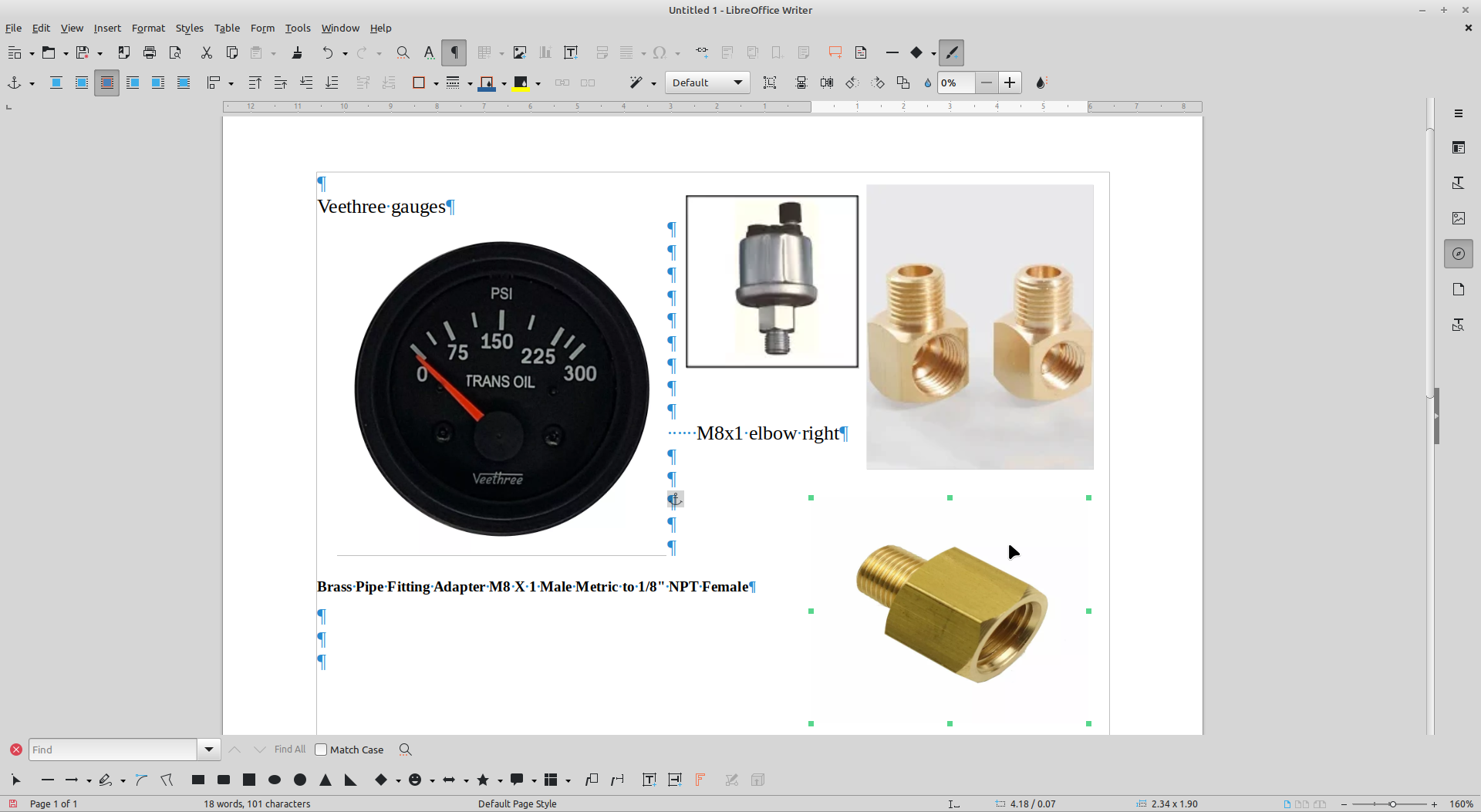

Having a 24v import mad it easy to wire up , just google Transmission Clutch Oil Pressure Gauge 24V with matching Sender . veethree gauges
you need two adapters.
you need two adapters.View attachment 3734064View attachment 3734065
