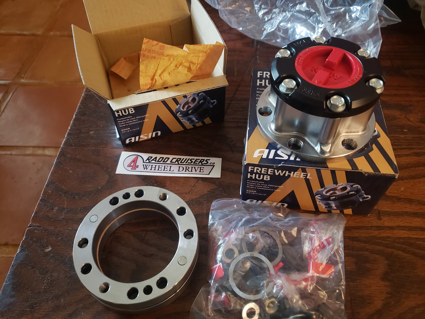

Definitely sounds like either one or both of your hubs aren't locking properly. Could be worn contacts, old sticky grease, failed hub motor. You could attempt a diagnosis and repair, or just go with a manual hub conversion. I believe both Cruiser Outfitters @cruiseroutfit and @Radd Cruisers sell kits to convert to manual hubs.
Parts finally arrived today.
