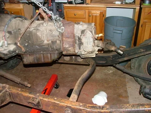

    IF you're going to anything like that, consider putting the 3FE in as well. there are a few threads around here. One guy actually tried to put this setup into his FJ40 and it was too long. So they wound up putting in a SBC instead.

    Yes , it would be too long for the 40,
    I have got one in my HJ6.

    cHECK my build in my sig line. I have a pic of a 3fe/a440 combo slung over my bare frame. You can get an idea of how long it is. It is loooooong. Page 1, maybe 2. The 3fe is in the same location as the f would have been.
    **edit** I'll make it easy:
