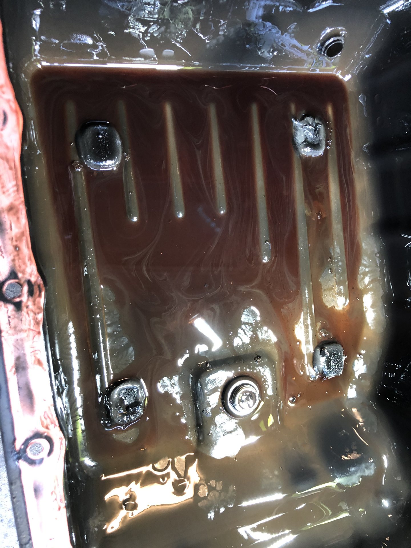

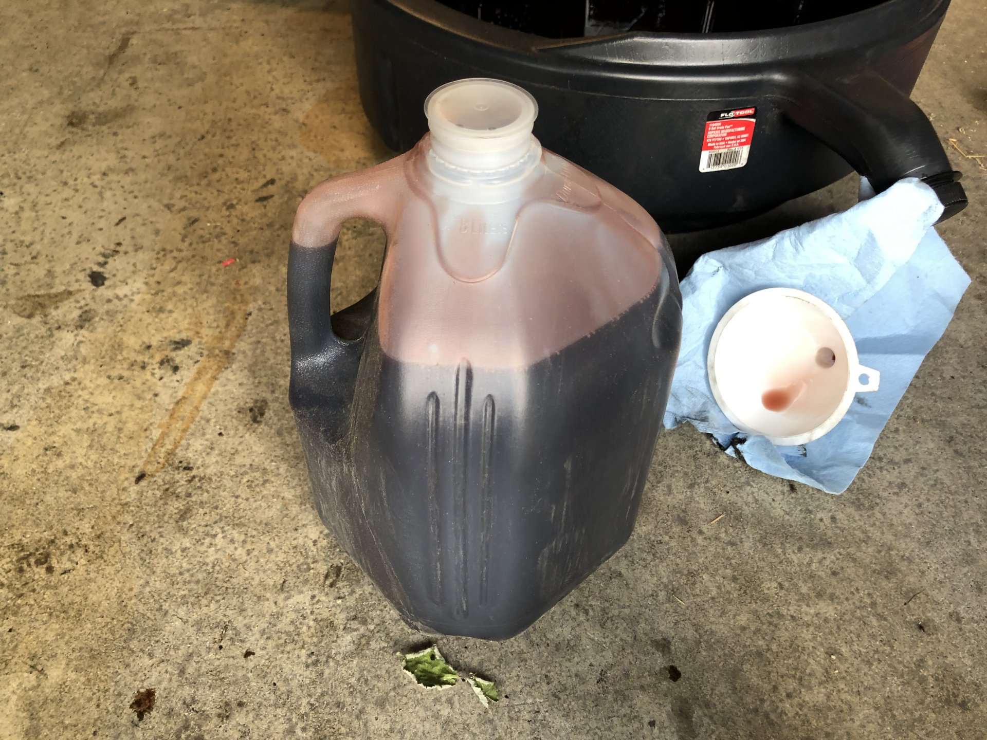

So I finally got to look in the pan. The fluid is dark but doesn’t smell burnt. There are some metal pieces like fine glitter in the fluid. Looks like no chunks of clutch. I may just go with the nomad valve body and a complete fluid exchange unless someone thinks my video and pics suggest otherwise. Any input? Well I guess I can’t put a video, but here’s a fb link:
