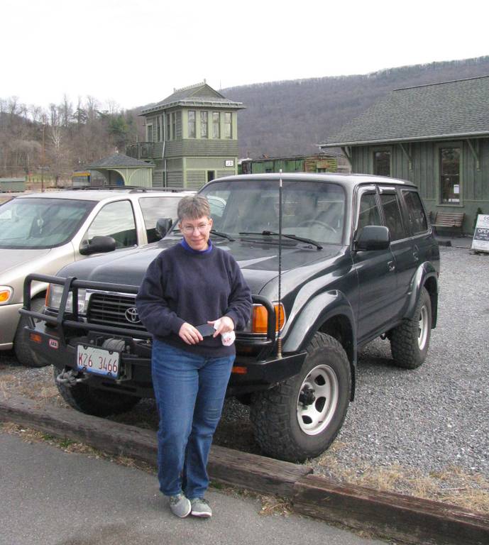

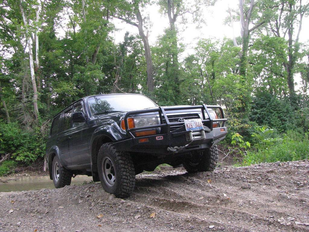

Even with flares, I always liked the looks of the 255/85 R16 BFG KMs under my old 80.
They do give a bit of visual height enhancement.
