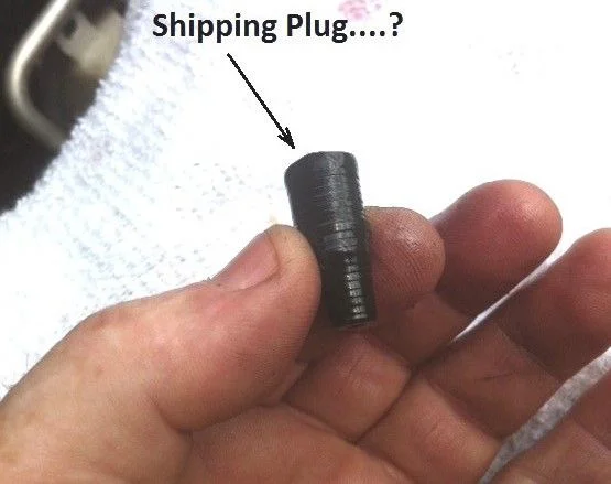

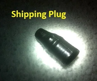

Actually found a shipping plug in one of the lines of mine (blocking it). Tranny was getting hot.

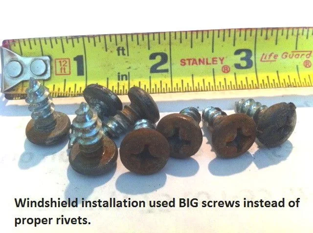

Bet you anything at some point someone used screws instead of the proper rivets and left the old holes uncovered or didn't fill the hole at the pinchweld.
Had water damage in the form of rust under mine because of this (screws).

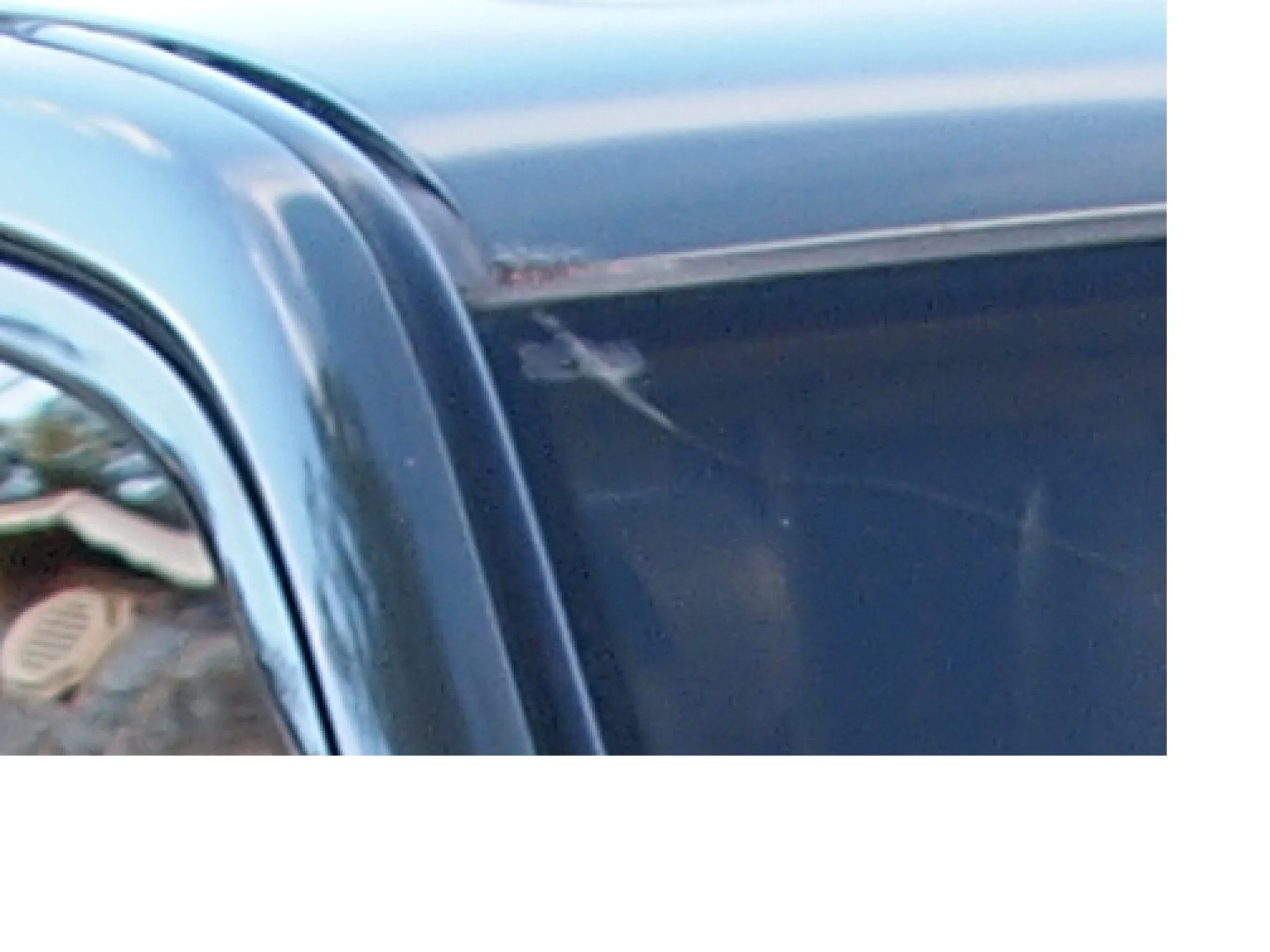

Just starting to leak now, after two years is not common. They usually leak as soon as bad install done. Rust caused by installer nicking paint, takes longer to create leak. This rust will often grow like a cancer and may crack the glass. These leaks are from rust holes into body.
